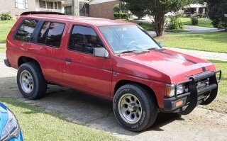

      Wait... "I found a Pathfinder with the front end of the D21 hard bodies"
      So that would be the 2 wheel drive version on the Nissan Pathfinder you have there?
    3. whoizitcc69
      whoizitcc69
      No its a 4X4.. I just replaced everything on the front end from all the ball joints, upper and lower, sway bar bushings, shocks, brakes and calipers along with new front axles.. now moving to the back stuff.. October I will finish up the engine tune up, replacing, and upgrading the timing belt, all new seals in the front, water pump, hoses, injectors, spark plugs and wires, valve cover gaskets and all new AC system..
