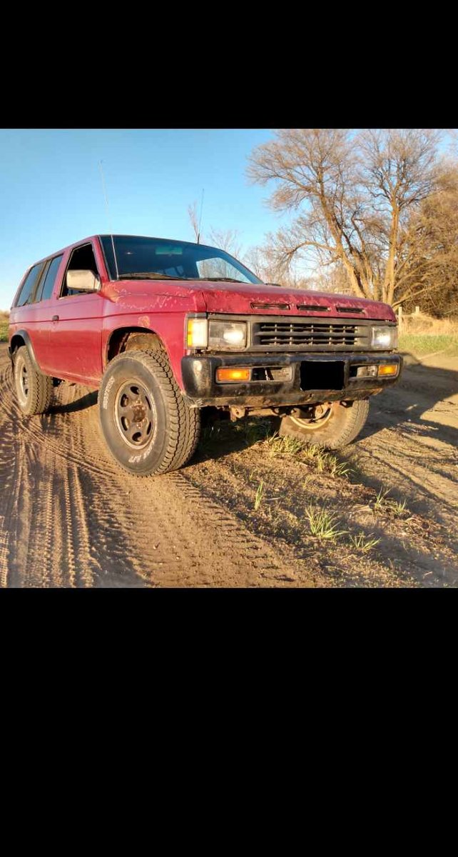

Couldn't resist! Way too nice out I had to go wheelin'. Avoided mud due to rust issues. Did some work on it today. (2 speaker/stereo questions below) 1) Used silicone lubricant on all door locks, latches, and hinges. As well as hood latch and release, gas tank cover release, window tracks, seat adjustment rails. 2) Cleaned it out, packed full of rat nesting $#!+. Particularly under the shifter boot. 3) Used degreaser on interior parts using toothbrushes and larger brushes. Vacuumed it out, still dog hair in carpet. 4) Bought replacement mirror material for driver door, screwed up and shouldn't have put the 3rd adhesive strip across center, made it like a fun-house mirror. Oops. 5) Bought WIX air filter (need truck to last, K&N doesn't filter well enough for that). The airbox was full of nesting material, I mean FULL! 6) Installed CB antenna, ran it through door channel and along the inside between the windshield and dash to the radio. 7) Bought some head gasket sealer juice that I will use when I know I won't be using the Pathy for a day. Not positive there's an issue there but I don't think it will hurt, I smell coolant burning while driving yet there's no visible leak that I've spotted yet. 8) ? Had a sandwich. 9) Temporary fix: spray painted over rust on rear bumper. As well as on the rear wiper arm that's peeling. 10) Bought seat cover for driver side (dirty job I have). 11) Outer door handle failed and heard a clunk. Proceeded to take off door panel to find every clip torn out of panel ?. And to top that off, he cut the door open to get to the mechanism easily, which sucks but made my job a little easier. Rod is missing between Outer handle and plastic sleeve. "Farmer Joe" took an old wire and twisted it to fit in there. Rod clips are broke so not sure I want to mess with finding the parts for them. Nissan doesn't carry them anymore. I just modified his work and bent the (heavy) wire to work tighter and not fall out again. 12) LED cargo light (will eventually change all lights to LED to reduce alternator keep-up, as well as custom color choices, I'm going to run all red , dash and all, except main dome light). 13) Started to work on installing my head unit and inspecting "Farmer Joe's" handy work with the radio... Joe installed old dial radio w/ no cassette even, had to cut the plastic to fit it in (install kit will cover it though). And he has one old computer-speaker wired that sits below the center console. All wires to factory radio were cut but accessable still. Random wires running to the back cargo area that look like they may have ran a system at one point, maybe. Two tweeters hooked into loose wiring, not sure if they are the originals for the Pathy's rear. I'll take a pic tomorrow when it's daylight. This leads me to a couple questions. I've searched the forum and understand the factory amp issue when installing a new stereo. Pathy already has the antenna adapter. And I could potentially figure out which wires are power from what's already connected. I'm going to bypass amp (if theres even one left). How do I access the rear speakers and factory amps? Do I have to remove the whole headliner or do the speaker covers pop off? (95 xe-v6 4 door). I tried carefully but don't want to break clips or whatever is holding it there. Speakers in doors are shot, paper cones are turning to dust so I'll likely replace all the speakers. No woofer system, just want the factory front and rear position speakers and tweeters. (Should I even run the tweeters if I buy 2 or 3 way speakers? Won't that require a crossover/amp?). Lastly I came across a few issues as I worked on the Pathy today. 1). Center arm-rest console was"Joe's trash can, not inside, but beneath it, cough drop wrappers and such, shoved in either through the e-brake pocket or through the missing switch cover hole. The arm rest was super wobbly, the front only has one bracket to attach to, and the back doesn't clip in. Found this out after spending an hour digging gnarly coins out of the screw holes, packed full of black resin-like grime. (Not drug related luckily). But I still can't see the screw heads, it doesn't bother me that much, after I put in my Drop-Stops they sorta wedge it in place. 2) Dimmer switch doesn't dim. 3) Crude patch under rear seat floor. 4) Cruise control may not be working, I can't get it to work. 5) Has fog light button wired in but no fog lights on Pathy. 6) Power door locks confusing, sometimes when I attempt to open the passenger door while unlocked, it locks all the doors as I lift the handle. Actually got locked out today, but nieghbor has Jimmy bar ?. More to come!

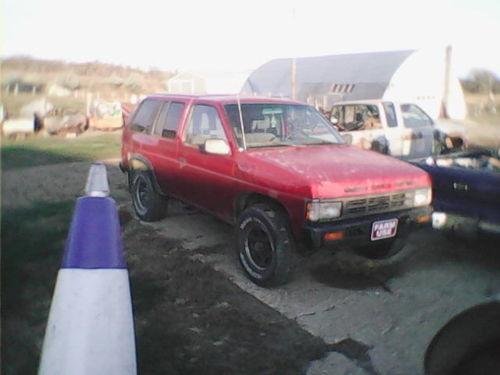

Hi everybody! I just got my Pathfinder today. 95, xe-v6, 4x4, 5 speed, 4 door, 130,000 miles (broken speedometer and odometer) reliable owner says add 15-20k to that number. Red with grey interior. Auto windows, locks and mirrors. You can call me JP for short. I used to own an 86.5 hardbody as well as another 86.5 and 87 hardbody for parts and an unfinished/abandoned truck bed trailer project. Sad to say I had to get rid of them due to a move over 5 years ago. The Pathfinder will be my daily driver but also designed for camping and over landing. Not necessarily extreme mudding or rock climbing. Truck has some issues that need fixin'. Starts and drives, has decent tires, drove it 70 miles to a workable location. If anyone could point me to the right threads to help out this forum noob I would highly appreciate it! Many problems I've dealt with before but tips always welcome. I have daily access to a machine shop and have intermediate skills with basic mechanics and fabrication. Just need to budget as I go. Problems at purchase: 1) valve head oil leak 2) radiator cap leak (came with new radiator in the back) 3) speedometer and odometer don't work (quit working on my old hardbody too) 3.5) tach is jumpy 4) clutch catches very early 5) hood latch release lever super tight and sticks in the open position. 6) air conditioning belt not attached (may not work, don't know yet) 7) rear tire carrier removed ? ? no roof rack ? 9) no spare tire or rim 10) minor rust issues Plans for truck: 0.1) fix above problems lol 1) new plugs wires and belts 2) better alternator 3) led headlight conversion 4) winch and mount 5) trailer hitch 6) light bar 7) basic tune up and suspension service ? warn manual hubs 9) finally paint Only had this for less than 12 hours so I'm sure I'll find more out as I dig into it more. Looking forward to being a part of the Pathfinder community, I always wanted one and am excited to get it working better than it has in the last decade or two. Thanks for having me! Peace.
