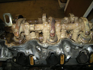

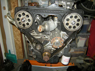

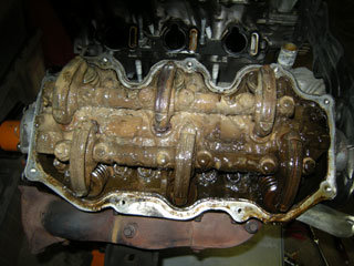

At least I know it wasn't the timing belt that was the problem! Bummer is... got the heads scraped out and removed the rockers and head and guess what? Block is still seized up, guess it's time to roll it over and start on the bottom end. I am totally bummed now!!!!
Weather finally broke and was able to start the teardown of the donor JDM engine. I was really hoping to just swap engine into my P/F, now I am just hoping that the block is salvageable. Have all plugs out and intake off and I still can't get the crank to turn more then about 10 degrees. If anyone is thinking about a JDM import engine be aware!, this is what I got. I think I need a bigger parts washer ! (he,he). I am soooooo bummed!
