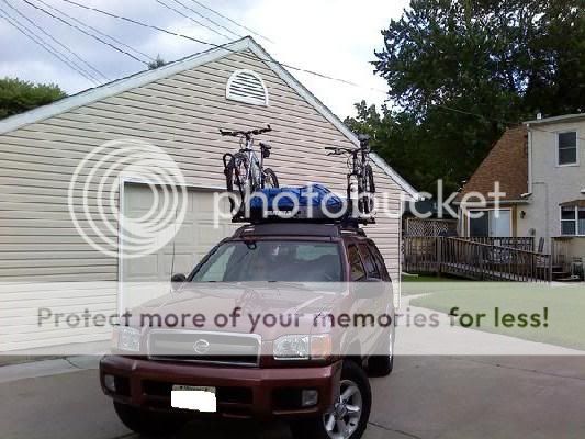

Here's my '03 SE with Yakima Railgrab towers, 58" bars, two bike mounts, and Loadwarrior basket. Works great!!! thumbsup.gif

I needed 58" bars, because I knew that I needed room for the basket and the two bikes. I think you can use 48" bars if they handle the load you want to carry. If you are carrying sheets of plywood for example, you'd want the longer bars so that you have room to tie the load down, etc.
There's nothing fancy about the Yakima load bars other than the plastic coating to prevent rust... and I think they price them the same for both lengths. My advice - FWIW - would be to get the longer bars. You can always cut them down with a hack saw if necessary. Remember, you can always cut some more off, but you can never cut any back on. blink.gif
