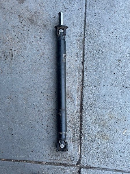

Good question - I did not check the pinion bearing in the diff. To be honest im learning more about this as i go, so id have to remove the rear driveshaft to check that again. As luck would have it, it's up on a mates hoist at the moment, so ill do that tomorrow. I believe the "phasing" of the shaft is good. Again, I don't fully understand it, but i believe it's the same correct orientation as your picture. Here is a pic of my tailshaft before installation. To be honest, i dont really understand how it would ever be incorrect. I wouldnt be able to phase it incorrectly if i wanted to????
