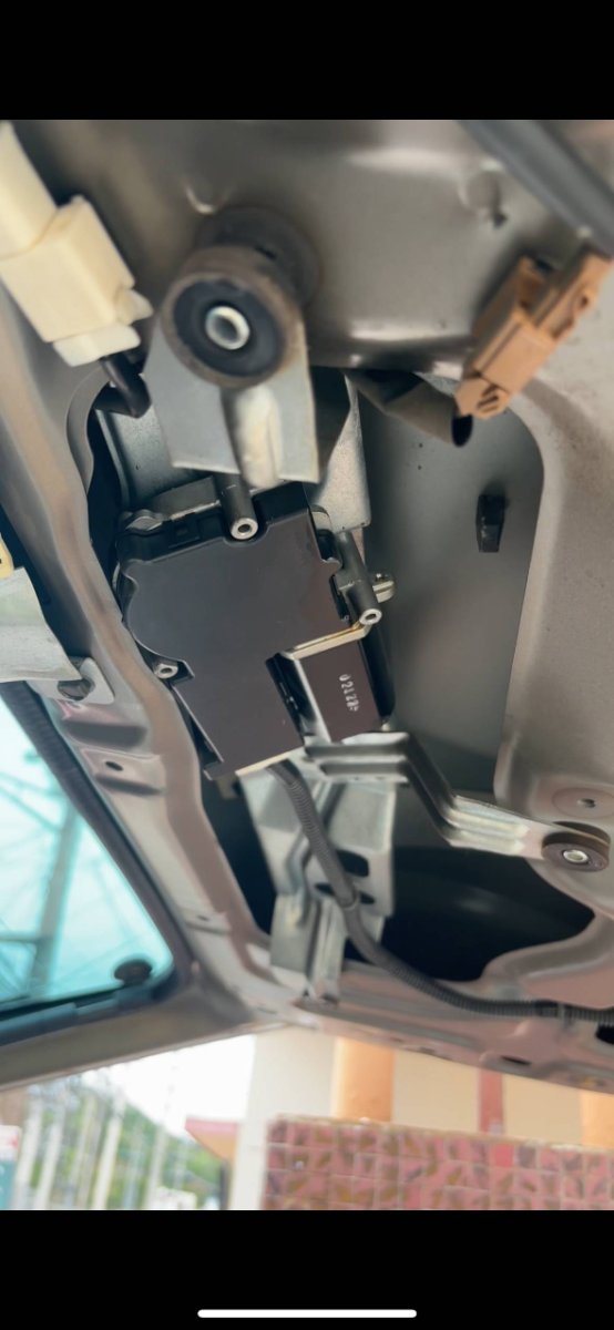

I'm trying to install a backup camera above the lisence plate but when I remove the trunk trim there is a part that I can't get out of the way after unscrewing it. What is this part called or how can I take it out without breaking it?
