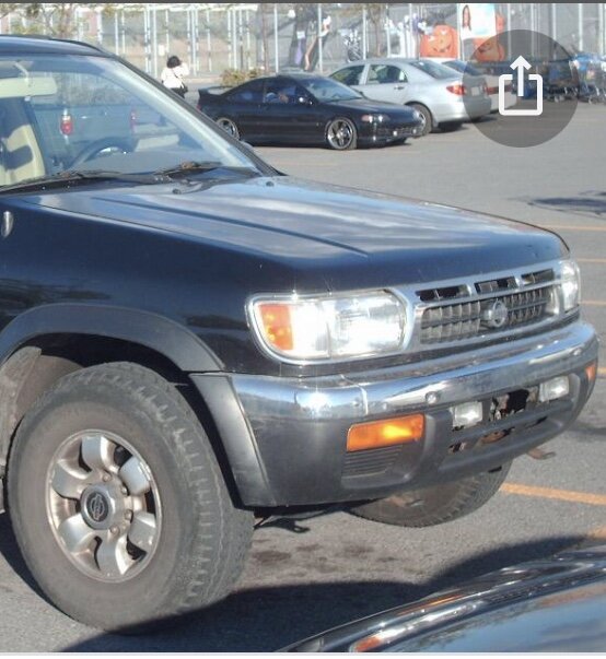

  1. Does anyone know what bulbs the rectangle fog lights with the glass fronts take? Picture is for reference, not my pathfinder. Also, anyone ever taken these rectangle ones off the front? What’s the best way to go about it?
