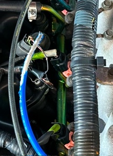

  1. I put in another new distributor, still getting the same issue. a possible reason is that a couple years ago, before this cylinder 5 misfire problem kept popping up, a rat made its den inside the engine bay and chewed through some wires and one of the plug wires. i reconnected the wires and replaced the whole spark plug wire set so I didn’t think it was a possible source of this problem ive attached a picture of the chewed through wires, anyone know what they do?
