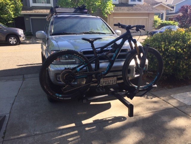

  9. Well, I did your collective advice and used the tie-down hooks as my base. Really surprised how beefy those things were considering. Anyway, I did not weld (because I don't have one but was this close to going to HB to buy a flux welder). I bought four 1/2 inch fine thread bolts (3.5 inches long). I just used a stack of washers along with the bolt through the tie down base to secure the bar, and used the same bolts to secure the hitch (I could have used 1/2 inch shorter bolts but eh). I installed my makeshift Yakima bike holder (probably weighs 40-50 lbs total),stood up on the end (I weigh 150 lbs) and tried to impart some downward motion and it did not flex. I then test drove around with my 30 lb bike and the bike looked solidly held. It's 11 inches to the lowest point (for reference, the diff pumpkin was 8.5 inches). I say it's good. Thanks for all the help! https://www.pinkbike.com/photo/18743859/ https://www.pinkbike.com/photo/18743858/ https://www.pinkbike.com/photo/18743857/ https://www.pinkbike.com/photo/18743856/

  12. You know, I just looked at this again and I'm very likely to follow your advice. I may even end up welding (I don't have one but I may have access to it). I also have the raw materials to make this work, although doing this drops the receiver height by two inches. I'll post up when this is done.
  13. Thanks for the response guys. I wasn't planning on putting a lot of load, less than 100 lbs of vertical load most likely (although if you look at it from a leverage standpoint, it is a bit more and requires a sturdier mount point).
  14. Has anyone installed this on their vehicle? I used the subframe at the bottom (below the radiator) and it was flimsy (I could see the top part buckle as I tightened the bolts). I ended up distributing the load with a strut (the bolts go through the struts) but it still feels flimsy. It's only meant to hold a bike when I'm shuttling. Do you guys have better recommendations? Thanks!
