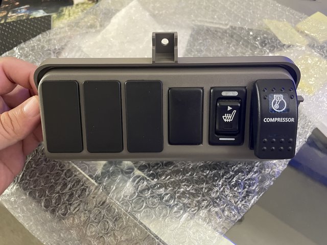

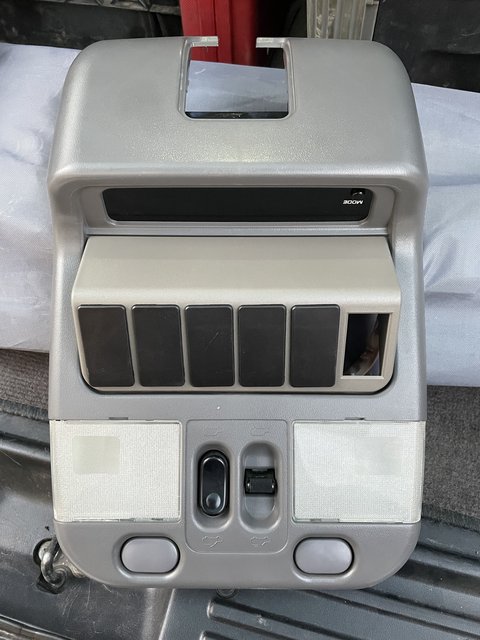

@R50JR sent me an ebay link the other week for a Patrol switch panel and convinced me that it'd fit.  I did some additional comparisons and agreed that it would.  I had some concerns about how well the trim colors would match (there was a "K" gray, "W" light gray, and "G" tan, as far as I could tell), since it was clear the trim color codes were not the same here (my all-black interior trim is "G") and all the photos I could find seemed too tough to tell the exact tone.  After some deliberation, I ordered the last pair of "W" "K" panels the seller had.
After waiting a few days, they arrived.  Product looked great.  The color was a slightly brownish-gray.  (My Frontier has a "K" gray trim, and it's not even remotely close).  In hindsight, the light gray "W" might have been good contrast.  But overall, I dig it.  Fitment is good.  Material quality is really good.  Getting the console down from the roof and detaching the wiring harnesses from the backside of the sunglasses tray was the toughest part.  Things may get a little more complicated once wires are up there.
The company that makes them is Kenay Kustoms out of AUS.  Unfortunately, they do not ship direct to the US, but I plan to reach out to them to confirm fitment based on the pics below.  They also made color-matching blanks, except they were out of stock of them.  The black ones were reasonably priced, ordered through the same ebay seller (dukes_4x4_and_camping) that sold the panels.
Anyway, some pics below.  Not sure what all I'll put in them yet, but it'll be way more useful than the worthless the sunglasses holder that doesn't fit any sunglasses I've ever owned.

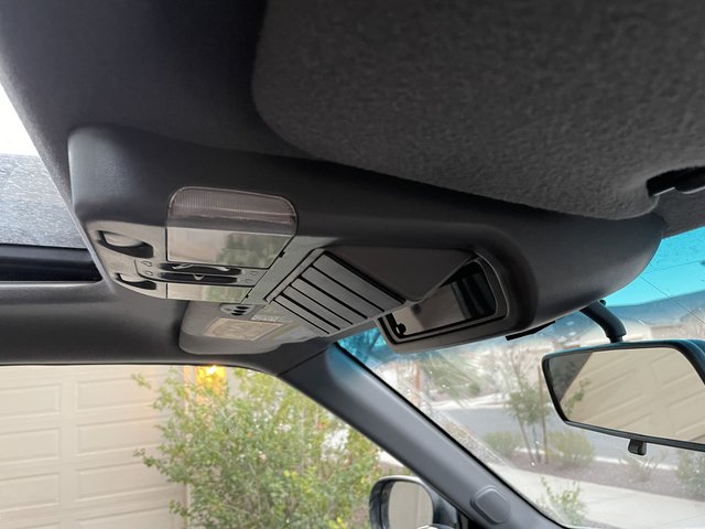

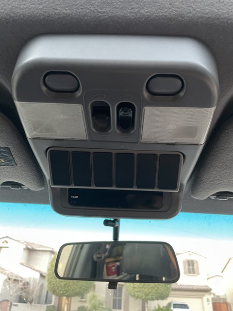

It does block the climate and compass readouts a little, but a slight head dip resolves that easily.  It's not something I stare at regularly anyway.
From this perspective, the color match is perfect:
And it's too bad there aren't any cool Nissan switches to put here, but they would fit reasonably well:

That is awesome use of an otherwise useless space, I love it! Mimics the placement of the outfitter switches on the newer Ford Super Duty. I'd also imagine that if the color difference really bothered anyone that much, it'd be easy enough to match it with interior plastic paints that are available, but for my utilitarian use it's fine. Just might have to pull the trigger on one of these (and yes, I just looked them up on ebay ). Nice find fellas!

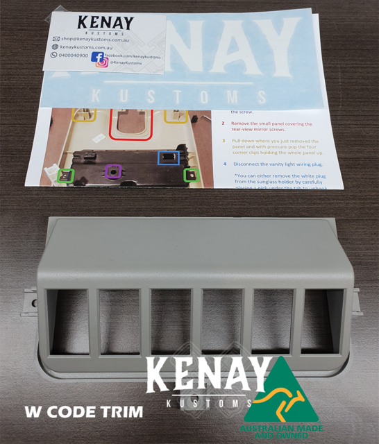

I also reached out to Kenay Kustoms and got a reply from the man himself, Kenay.  An interesting notable was that the panel also fits an older Subaru Forester console.  But he did share some advice about the color trims and thinks the "W" might be a better look.  I'm checking if he's okay with me posting up some of the trim color pics here to keep the colors convo in context.  He also mentioned changes to the website to allow for shipping to the US soon.  (Duke's Camping also did a great job on the ebay transaction, despite ebay complicating things; they sorted everything out very quickly.)
This is an awesome find. I ordered one as well, not sure what trim color it matches but honestly I couldn’t care less because a quick shot of paint will make it whatever I want. I just want something to replace my current set up because it’s too cramped behind the panel with all of the wiring and even though its functional, it does look out of place
I've been exchanging emails with Kenay and he's been very helpful.  Here's the trim pics from his website (https://kenaykustoms.com.au/) so that we have some consolidated info here:
Order in the pic above: W, K, G
As mentioned previously, he is planning to update the site to allow for shipping to US, price will be around $70 AUD shipped (about $54 USD as of today).  I may actually pick up the W trim since I light gray might be a nice contrast.  But, I can wait out @PathyGig12's review...keep us posted.
