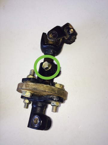

XPLORx4's original instructions are the easiest and quickest solution, and this is correctable in a few minutes.  Follow his instructions above, except please also disconnect the battery since you're potentially dealing with the airbag due to the clock spring.  You are looking for this steering linkage:
Loosen the bolt in green and completely remove the lower bolt as shown.  Then you can collapse the link to disconnect it from steering rack (if you need the link to collapse more, remove the bolt in green).  Go back inside the truck, gently rotate the steering wheel back into the correct position, and wrap the seatbelt through it to keep it from spinning.  Back under the truck, avoid rotating the link any more than necessary (the seatbelt will allow some movement), align the lower part of the link and extend it back onto the steering spline.  Reinstall and tighten the bolts.
Hopefully the direction you correct the steering wheel is in the correct damage as to not damage the clock spring, as mentioned previously.  Rotate it slowly and gently.  Stop at any hesitation.

Thank You very much for your help, it works without having to remove the rack and pinion. but when I centered the steering wheel then remove the jack the steering wheel is off again, is this because that my tires are worn out?
How far off is the steering wheel after you perform this procedure?If it's off by more than 12 degrees, you can adjust the link indexing by one spline. If it's off by less than 12 degrees, you'll need to adjust the tie rod ends to center the steering wheel.
