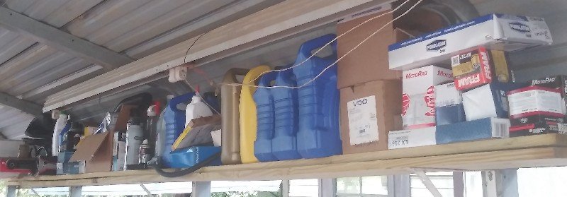

So I finally started useing my ever-growing pile of parts, got engine tuned up. Next I'll service the transmission, and install aux cooler

So my parts pile is almost complete. Still waiting on a few items from Rockauto, panhard bushings, and my OME HD springs from Desert Rat. I spoke to them yesterday, said he was allotted 3 pairs (1 is mine!) and should have them week after next.

We got called back to work so I'm not gonna have all the time I want for this project, but at least I'll have all the parts for as I find the time!
