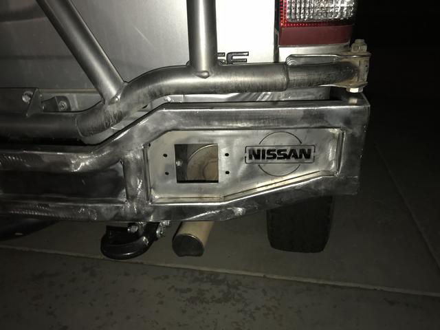

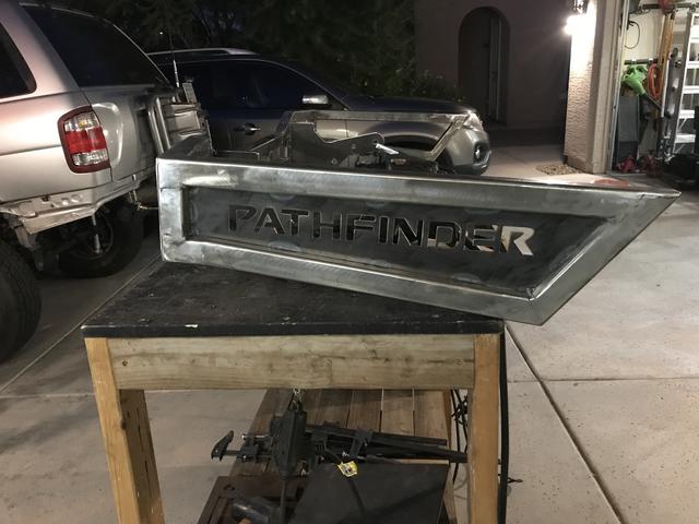

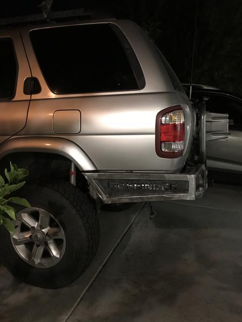

In hindsight, I wouldn't have made the corners stick so far back, and maybe not so low either.  Still to-dos are finishing the other insert panels (waiting on the lights tonight to confirm the mounting pattern), and put some plate on top to get some flat surfaces.  Right now it comes in at 62 lbs.  It'll probably be able 75-80 when done.

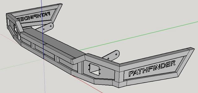

On a side note, I started sketching up a plate version of this with some wild dream about producing a DIY kit.  Still a lot of clean-up to do on that idea.
Looking pretty good. To be fair, you need some depth to it to be able to stand on it & to be able to put stuff on it. I think it is just the sharp 90* outer corner that you don’t care for. Not that it wouldn’t be too much work but, a diagonal on those outer corners would likely eliminate that visual aspect which catches your eye as a little too long.
Thanks.  I guess that's a good point as far as a step goes, though I usually find myself standing on the tires instead, since it's a bit of a reach.  That's one downfall of using tubes...getting all the angles is a pain.  With plate, much easier of a problem to deal with.

To be fair (does anybody watch Letterkenny?), these weren't built for impact; they were built for clearance, so concessions regarding coverage and strength are being made deliberately.  My wheeling trips were literally ripping my OE bumpers off every time, so you could say these are built for less contact.  By contrast, ARBs are designed more for impact and less for clearance.
I think mine would sustain direct impact well given their coverage, and they offer significantly more strength and coverage than the OE bumpers, but it's just not what they were designed for.  The only regular road hazards we have here are skinny coyotes, fat rabbits, and stupid quails...none of which will ruin my day when struck.  Will these hold up to bumping into, or dropping onto, immovable boulders?   Yes, I think they'll do fine there.  But at least for the front bumper, the shape and angles will be more apt to cut into something instead of distributing impact like a plate bumper can.  So no, I don't think it'd fair well against a deer unless it was a dead center where the most steel (tube, winch channel, brackets) is present.  The rear bumper...I really don't have much concern about it; it'll be reasonably stout when done.
Good design and fab work!
I like the stick out and agree that with an angle back towards the wheel would look cleaner visually. I'd go so far as to say that an angle towards the the rear wheels would look good both from the side and from the rear. That is ti say, 2 changes could be made.... But I'm not doing the fab, just commenting from the galley lol.
In any case I like the reasoning for the build. Keep things light and functional, not a hardcore bumper or guard but still much mote stout than stock.

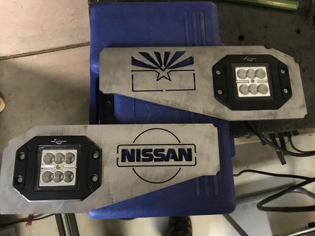

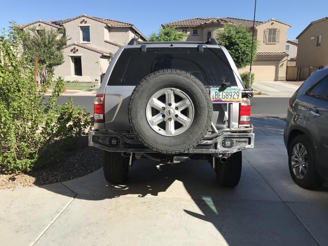

Well, it's as done as it's gonna get before my CANVAZ trip this weekend.  I will eventually put some plate up top and some additional brackets under the quarter panel for support.

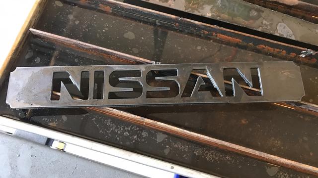

I've been pretty pleased with the cuts.  My AZ flag apparently had some hidden lines that got cut, but I went with it.  Cheapo MicTuning lights off Amazon are wired to the reverse lights...and make the OE bulbs look like garbage.

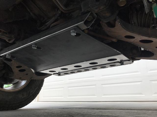

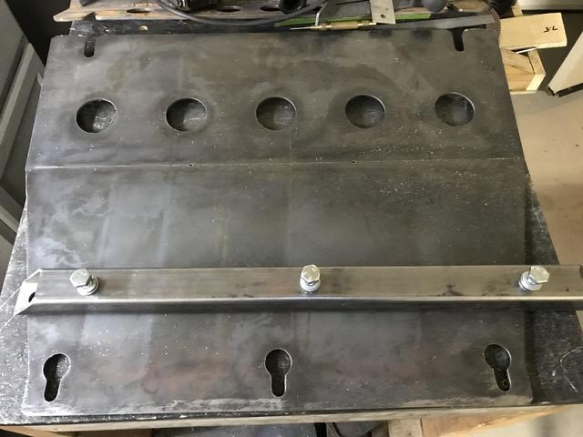

I also made a new missing link and mid skid...
Super pleased with the results.  It slides on/off just like the front skid, and now all the hardware is matched for a single socket.
