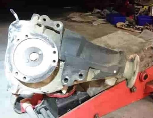

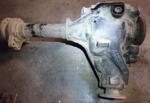

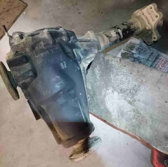

I've got a Diesel R50. I've pulled out my front diff and am looking for a locker for it. ARB and other catalogs state from 86-15 that 4cylinder vehicles have an R180. I'm pretty sure i've got it in my head from somewhere that all R50's were R200a. Does anyone know their Pathy diffs?

I took the back cover off and was able to count the Ring Gear bolts. Had 10, l was also able to measure the edge and eye up how wide it was which seemed inline with being the R200a (200mm ring). So locker ordered. Going to help pull it through heaps more places.

I can see why you had questions about the axle.  They shouldn't have overlapped the WD21 applications with the R50.  R50 is 29-spline R200A front and 33-spline H233B rear only.
