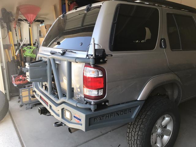

Adding @Astrorami's build link to the thread, since we completed his last weekend.
His is the newer style aluminum carrier, which weighed around 36.5 lbs vs. the 58-lb steel carrier.  For his, we used a 1.5" x 14" (14.5?", I don't recall already) 14ga steel strip and a bunch of 1/4" and 3/16" rivets, in addition to the rivnuts.  I was very pleased with how that turned out; barely any deflection when pushing or lifting the support bracket.
9428-F60-A-073-D-45-BA-807-D-62952-AF40-
Admittedly, we installed the hinge mounts about 1/4" too high, which created some alignment issues with the support bracket, as well as made the lower plastic hinge cover come up over the tail light a little.  Overall, pleased with the install despite that issue.
8750-AA64-B3-E8-4-A0-A-942-C-5-EF14-A3-B
The release lever on this model is lower than the older models, so it doesn't contact the valence panel on the liftgate, about a 1/4" gap.
55662218-BD31-455-C-9471-C9-CE300739-C5.
617-F3-B87-D4-A4-45-B7-B4-C9-5-CC35-E6-D
We didn't come up with a license plate mount or lighting...the aluminum frame tubing had a larger diameter than the vinyl-coated clamps that I had.  Since it was very late (er, very early in the morning), we just cable tied the plate and literally taped a freebie Harbor Freight LED light to it so that he could legally drive it home that night.
We also did not wire up the switch for the tire carrier cluster light that looks like a hamburger.  Just like my experience, his switch did not match the harness that's there, which seems to confirm that there's some additional pigtail wiring that needs to be grabbed from a donor to avoid having to splice wires.  Oh...and I also learned that long ago when I did mine, I flipped the hole opening for the switch...Astrorami gave me grief about it...the hole for the switch body is supposed to be on the right of the screw hole.  I had put it on the left, and we did the same on his just because the positioning on the reinforcement template was already set (and because it doesn't really matter...you can just as easily flip the plastic depressor piece on the carrier to make it line up).
Lastly, I don't recall finding any set of 5 M12x1.25 locking lug nuts when I looked years ago, but they seem to exist now.
McGard 25442: http://www.mcgard.com/product/chrome-cone-seat-wheel-lock-set-m12-x-1-25-thread-size-set-of-5-locks-and-1-key/
(I'm still using the Rugged Ridge 16715.22 single wheel lock.)
