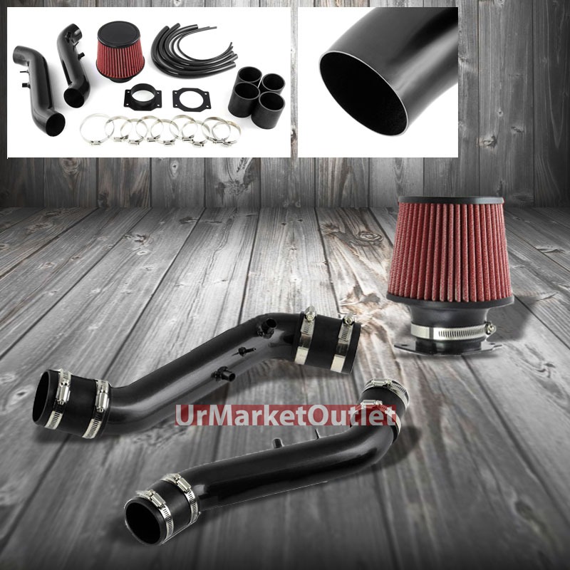

http://www.ebay.ca/itm/BCP-RED-91-95-Pathfinder-PickUp-3-0L-V6-XE-SE-Short-Ram-Air-Intake-Filter-/141533806377?pt=Motors_Car_Truck_Parts_Accessories&hash=item20f4127f29&vxp=mtr
There's a pathfinder specific kit on ebay
comes in red or blue from what I've seen.
Edited by Nefarious
Pipe is pipe and silicone is silicone. The only downfall there would be filter quality, which can be swapped out easilly. I'm going to build my own similar to that, but it will lead into a spectre inline air filter and then into a snorkel to avoid the water issue :)
  • 3 weeks later...
The 300ZX uses a smaller MAF. I was able to use the pipe and air cleaner from that kit but had to modify it to work. Would have been easier to just but the Pathfinder kit. I also bought a Electronic cutout, but not sure if I will use it.
