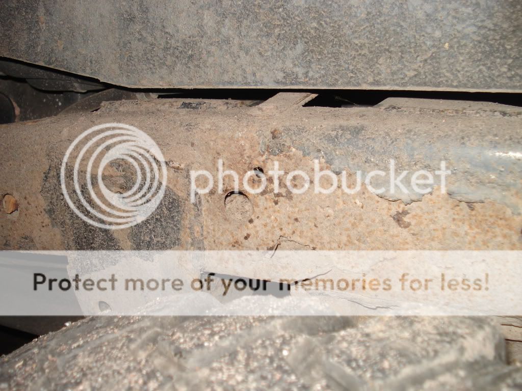

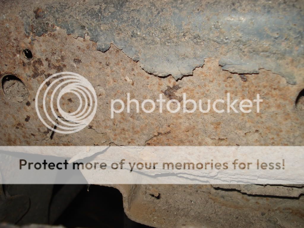

It's probably worse than it looks. I did my rear framerails last weekend. My Pathfinder had been getting 'weird' feeling for lack of a better term. Felt like a convertible crossing railroad tracks, lots of shudder over bumps, etc. I found cracks around the panhard bar mounts on the frame (3/4 of the way around!). Also found that the upper spring perches were at different heights from bending.
I used a needle-scaler to clean off the surface rust, and soon found out that the metal was paper-thin in many places. On the passenger side I ended up replaced 3-sides of the frame rail over a distance of almost 30"! The only intact metal was the top section of the frame, the sides and bottom were essentially gone.
It took me about 4 hours to repair the driver's side, but the passenger side also had rust at the lower trailing arm mount, and the fuel lines were so rusty that when I tried to bend them out of the way all three lines (pressure, return, vent) snapped and started leaking fuel! So I ended up removing the gas tank (PITA with a trailer hitch BTW), and replaced all the flexible hoses, hose clamps, and the metal fuel lines. I used stainless for the hard lines, I don't want to do this again! So the passenger side took me almost three days to complete, working about 5-6 hours per day. This was on my car lift, I can't imagine doing this on the ground.

I downloaded some pics tonight of the frame damage I had. I only realized afterward I didn't take any pics of the repairs on the passenger side. but it was pretty similar to the driver's side.
How did you weld the hole inside and around the coil spring perch on the inside of the frame?
I welded the inner part of the frame from inside the frame, after the outside skin had been cut off.
