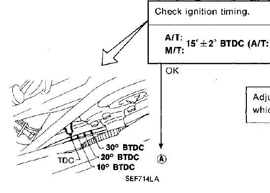

gustycrosswinds Posted February 2, 2022 Author Share Posted February 2, 2022 As an update. I took my pathy back to the guy who put the pulley on wrong when he did the timing. I got it back and checked the ignition timing and it's all lined up again. I am still have idle issues when the pathy is to operating temp. I believe I did not set the TPS correctly when I replaced it last week. I will go back in today and see what I can do. The marks for ign timing start at -5 correct? And increase by 5 each mark, so the 15 degrees BTDC should be the fifth mark? If anyone has a good youtube suggestion on how to set the tps on our rigs, that would be great. I have found youtube to be very helpful when I tackle fixes that I do not fully grasp just from reading the chilton or haynes. I watched a few generic tps adjustment videos and I'll just go from there. Lucky to be borrowing a friend's garage when it is -1 out today. Link to comment Share on other sites More sharing options...
adamzan Posted February 14, 2022 Share Posted February 14, 2022 (edited) The marks start at 0. So if you have 7 marks it goes 0 5 10 15 20 25 30 left to right. The pulleys came from the factory with a white paint on 4 marks. The marks referenced here: The one with the -5 at the start is for the 4 cylinder models. Edited February 14, 2022 by adamzan Link to comment Share on other sites More sharing options...
