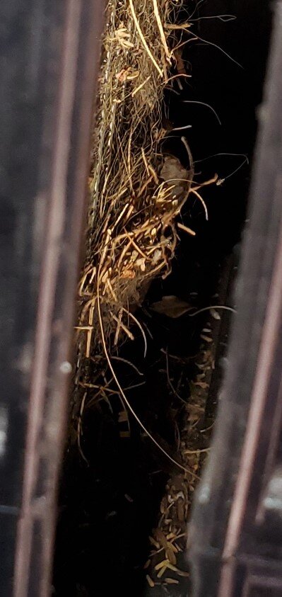

That is by far the most informative, helpful post I've ever seen on any topic on this forum! I'm going to Oreillys after work to get the gauges and check all of the pressures. I pulled my cabin filters yesterday for the heck of it, thinking maybe I'll have a little stroke of luck and this will solve my problems. I realized I had never changed them! Not something I'm proud of however, when I pulled them out and took a peek inside, I have no idea how any air at all was able to get into the cabin. It definitely made a difference when I pulled them and cleaned it out, but there's still something wrong that we'll find out tonight. It just doesn't have that "bite". It's not miserable driving around, but enough to where you're sweating. Definitely not where it needs to be.

Here's what it can look like if you neglect the air flow/filters inside your Nissan! Don't be me!

Yep, dirty cabin filters are something that sneaks up and prevents the HVAC from working well, but usually the complaints I get where the filter caused troubles was low air flow from the vents.
