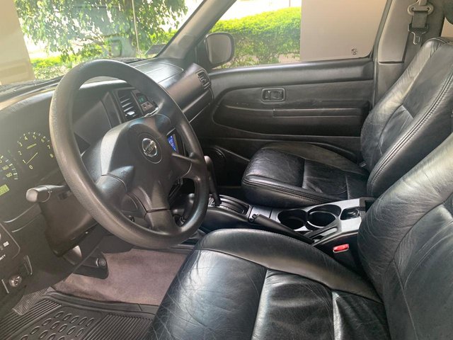

This is the 130k miles '03, fairly loaded example (the bumper is now repainted). Maybe it was from someone who frequented these forums? VIN is: JN8DR09Y03W803820.

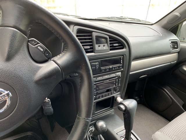

This is the '04 with 80k miles:

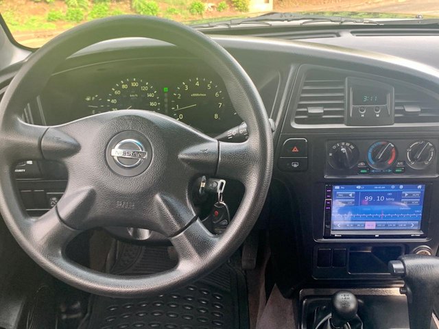

Then today I found this in FB's marketplace, but it's a bit far from where I live. Still not sure if that dash on the passenger side is sun damaged or if it's just the photo. Price is right and has relatively low miles (120k). Also imported from the US but has been here since 2005:

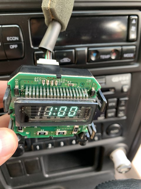

Clock fixed! Resoldering did the trick:

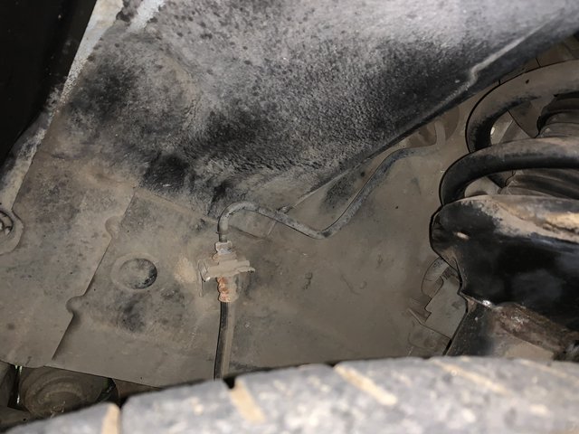

Obligatory strut tower photos:
Nice! I thought '03-'04 had the drive-by-wire, but Nissan's model year changes tend to happen mid-year, so I'm guessing yours is early '03? The strut towers look great.
