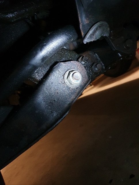

Tractionaction Posted July 8, 2020 Share Posted July 8, 2020 Gday gents are we talking about the bush behind this mount, mine are well flogged out and I tired to get them apart once without much luck, resulted in a damaged nut hence the replacement. PS don't mind the oil leak its on the list Link to comment Share on other sites More sharing options...
