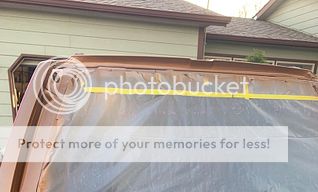

Info on the build: 1994 Pathfinder XE, manual trans, 4x4. First project I had with this: replacing the rear window that some punk*** kid shot out. 01/15/2020:jrEgGZIjQoKTJrujVJpkyQ?viewBox=731%2C975&ownerId=A3DTK741ARUMEV
Since then, I've had a bit more "fun projects." Just installed the 3" body lift, and am doing some body work. Both front fenders are being replaced due to some rust/dents. The car will be painted with TCP Ginger Metallic. Pictures will be updated with that project. For the time being, I've just been removing the trims and fixing the rust. The body is still quite rough, so I'll be using some light fillers to fix some of the imperfections/weld spots. 04/18/2020:
