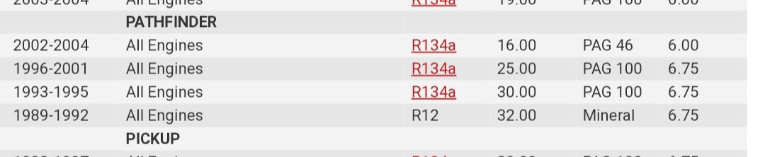

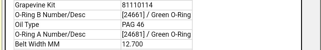

hawairish Posted December 13, 2019 Share Posted December 13, 2019 This is a little connecting-the-dots, but I'd be certain it's PAG-100, too. This is based on a few things: NTB96-023a, which is the Nissan TSB for converting from R-12 to R-134a (Link) lists 86-92 D21 as using the ZEXEL DKV-14C compressor and requiring "Nissan A/C System Oil Type R" (p/n KVH00-PAGR0), with the "R" being for rotary vane compressors. "Type S" is for swash plate compressors. The 1994 WD21 FSM says it uses the same DKV-14C compressor and Type R oil, and also confirms that the model type is "vane rotary" (pg. HA-116) This (pg. 1, #70) and this (pg. 13) and this (under Infiniti Zekel DKV-14C) and this (as Zekel DKV) and a few others show as using PAG-100. Notably, the Four Seasons 58440 compressor is vane-style compressor that specifically uses PAG-46 according to the 4s website. Same seems true with other aftermarket replacements. But at least per the internet, it seemed largely that "Zekel DKV" compressors use PAG-100. The real question now is if your 94 donor compressor is OE. A few months ago I did a R-134a conversion on a 91 Land Cruiser. Finding good information was a joke. I eventually found a Toyota TSB that spelled most of it out, but still left me with a ton of questions. I had to do the same stupid OEM name vs PAG-equivalent look-up, so I totally feel your pain here. Link to comment Share on other sites More sharing options...

RCWD21 Posted December 13, 2019 Author Share Posted December 13, 2019 I'm pretty positive that I need to get pag 100 oil Now the question is do I put in 200ml or 220ml of oil? https://ibb.co/82Pv1JFhttps://ibb.co/1KcFqMshttps://ibb.co/fH6J5Gk Link to comment Share on other sites More sharing options...
