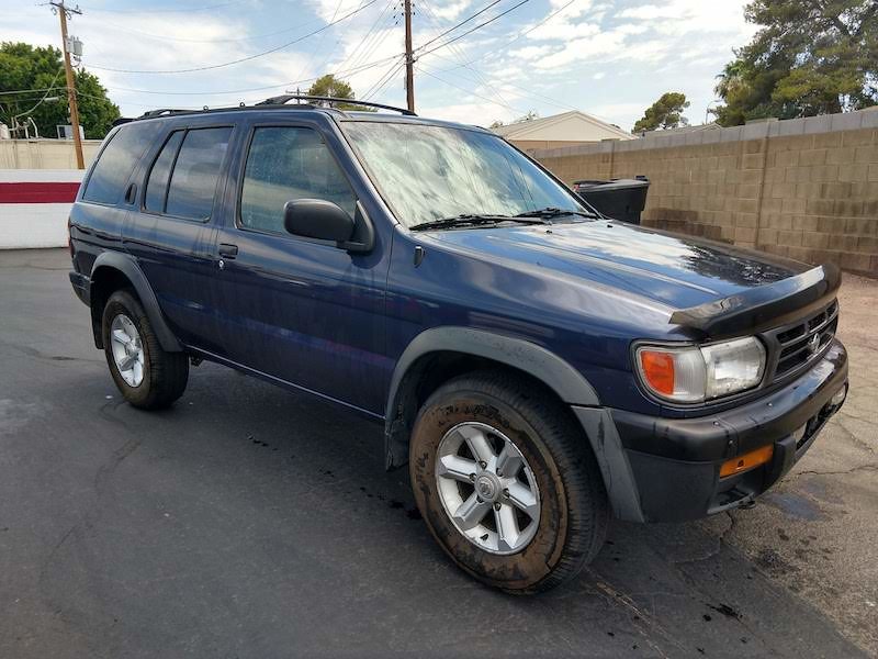

I guess I'm one of you now.
I've been looking for an R50 for a while now, and went to check out a few that were posted on FB/Craigslist today. I ended up walking away with this diamond in the rough.
It's a 1997, 4WD, with the LSD (of *course* I checked for the sticker...before even test driving it!). It's got around 220k on the clock, but the previous owner had taken very good care of it. No real leaks, the interior is clean, and while it's got a few little bumps from being 22 years old, the paint is surprisingly not completely oxidized (pretty common in Arizona heat).
I'm going to spend the summer just combing through everything and getting it back to 100%, but the first mod on the list is tires and a mild lift. Maybe a keyless entry for convenience before that.

It has facelift wheels, same ones I had before I got new ones
Welcome. Like the blue!
Used to have a pre facelift r50 myself years ago.

Yeah, I guess the previous owner put them on. I'll probably end up replacing them completely when I do tires.; they have a good bit of road rash on them.

I honestly thought it was black in the ad, but I'm more partial to the blue myself....I haven't seen many that color, mostly white, black, or red around here.
I kind of like the "classic Nissan" look to it, but the post-facelift ones are sexy in their own right. I've just been working on cleaning it up today (the above pic was just a quick spraydown at the self-serve wash). All that chalky gray fender plastic is black and shiny again. Some of the black metal painted parts I'll get around to removing and painting later on, but just getting those back to blackish goes a long way.
