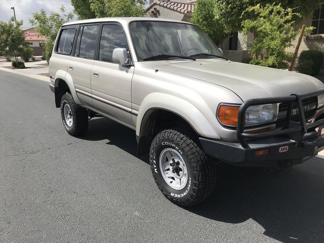

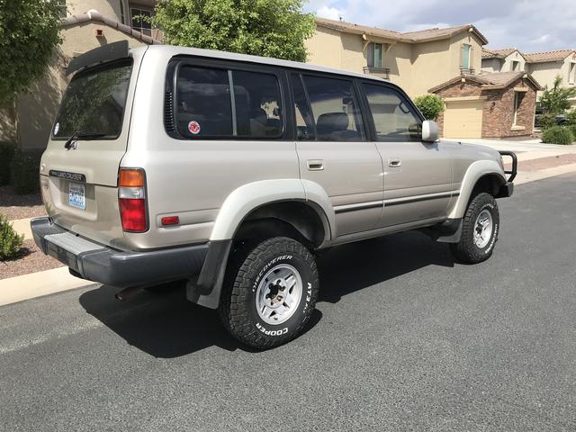

Is there anywhere we can see this land cruiser? Sounds like a cool project, and I’m always interested in the rides that people are working on. Pathfinder or not it’s the same passion.

These are the latest I have from the other week after getting most of the lift done.  OME 3" + shocks, IronMan 4x4 front and rear panhard/trackbars, poly bushings.  31"x10.5 Cooper Discoverer AT3.  It's my brother's truck that he bought off a buddy for a great price, but since he lives in WA and his buddy lives down in Tucson, I've been the middle man transporting it up here, storing it, repairing it, etc., until we can figure out how to get it up to WA.  I still need to swap out the bushings on the radius arms, do the RMS and oil pan gaskets (leaks!), and get the A/C plumbed and charged.  I rebuilt the compressor for it months ago, but it basically has to be the last thing done because Toyota sucks.  I'll put it this way: if you had to replace the passenger motor mount or the TWO lower radiator hoses, you would have to disconnect the A/C system and pull the compressor because they're in the way.  It's crap like that that thoroughly pisses me off, and just about everything on the truck is like that.  Front shocks took me 2.5 hrs to replace, rear sway bar about the same JUST to replace the bushings.  BS all around.

Is this the brother we met when you visited? You are an AWESOME brother to tackle that big of a project for him. Kind of looks like a Pines to Spines Delivery Vehicle to me (eh[mention=37543]TowndawgR50[/mention]?)
Honestly, that would be a fun roadtrip!
Yep, @RainGoat, that brother. He sold the GTR a few months ago, but recently won an Japanese auction for a 91 Nissan Figaro that should arrive there in a couple months. But yes, we’re still working on the details to get the truck up there. I might drive it up, or we might meet halfway in Sacramento.
