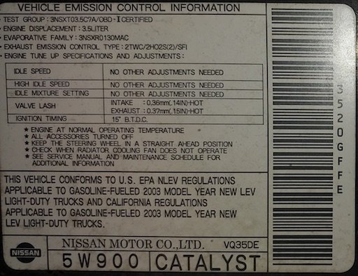

The FSM calls the cats nearest to the engine “warm up” cats. I can’t find it to save my life now, and it was probably anecdotal anyway, but I read that CA emission laws require the catalyst system to have the nox output in a certain range by a certain time while the vehicle is still warming up.
Then there’s the two different configurations and you can see which you have by whether or not your catalyst tag under the hood says California approved or not.
*you can also see here in this pic that it says “2TWC(2)” which is 2 three way catalysts multiplied by two banks for a total of 4 cats on CA approved models*

@onespiritbrain Thanks for bringing up the under-hood Vehicle Emission Control Information.  Unfortunately, Nissan changed the emissions setup between your year and 2003.  I think the inspector I spoke with today said that the 2002 had 4 catalytic converters, but in 2003, there's only supposed to be 2.
Here's the label from under my hood.  I believe it is saying there are 2 Three Way Catalysts and that's it.398086586_VehicleEmissionControlInformation.jpg.441ed5c29f4ce11dc2020242c668233d.jpg
