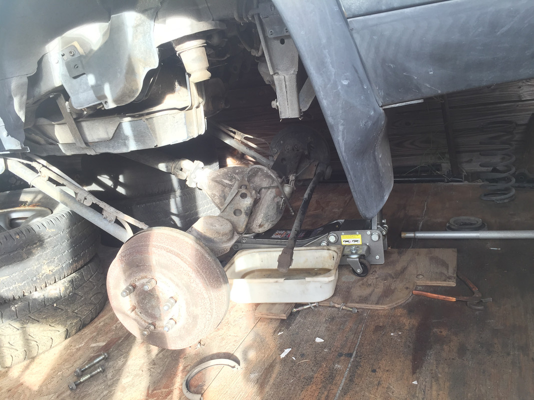

Instead of bringing the upper trailing arm mount down, I'm bringing the mount on the axle up. The gas tank is seriously in the way for doing any sort of work up there and I do not want to lower the tank. The plan is to fill the front and back with another piece of 3/16 and burn them in to strengthen the bracket. Not my brightest idea, but it beats dropping the tank IMO.

That bracket is interesting and might not be a bad starting point. I can see your reasoning for bringing the axle mount up instead of the body mount down and actually don’t think it’s totally crazy, lol. What are you going to do for the lower arm mount? I’m just thinking in order to keep the upper and lower arms in relative alignment with each other, they both need to be either raised or lowered from the same side. I. E. either lower both at the body or raise both at the axle. Or maybe it doesn’t really matter so much if they’re not kept in stock alignment with each other...idk.

Yes of course! That is what I spent this afternoon doing. You beat me to it. This afternoon I mocked up the lower trailing arm drop brackets! I'll post pictures in a sec.

Here is what I spent this afternoon doing. I mocked up the 3/16" brackets for the lower trailing arms. The bolts are in temporarily and they are just there to hold the bracket in position while I welded some of it in. Unfortunately, In the shed I'm working in, there is literally less than a foot on the side of the car, and it's not ideal to do work like that. These brackets are not done, nor fully installed.
The plan is to box the brackets in, and once the rear end is done I can push the car out of the shed. Once out, I can get better access to the brackets and weld them in fully.
