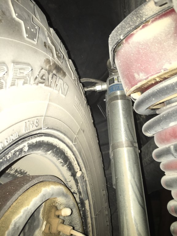

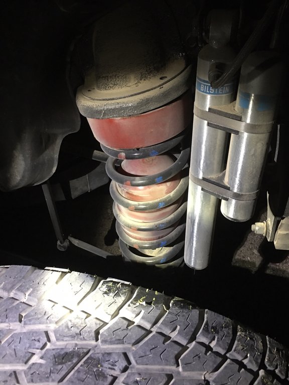

As for the Bilsteins, I like how they turned out overall, but that straight fitting concerns me.  It's fine for everyday use and some trails, but a hard tuck could be really bad.  I have an idea on how to correct that, and probably fix TownDawg's problem of too-long shocks.

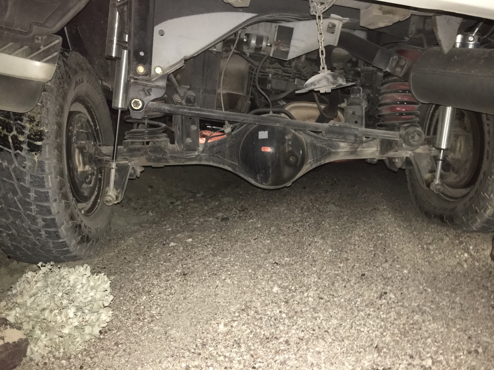

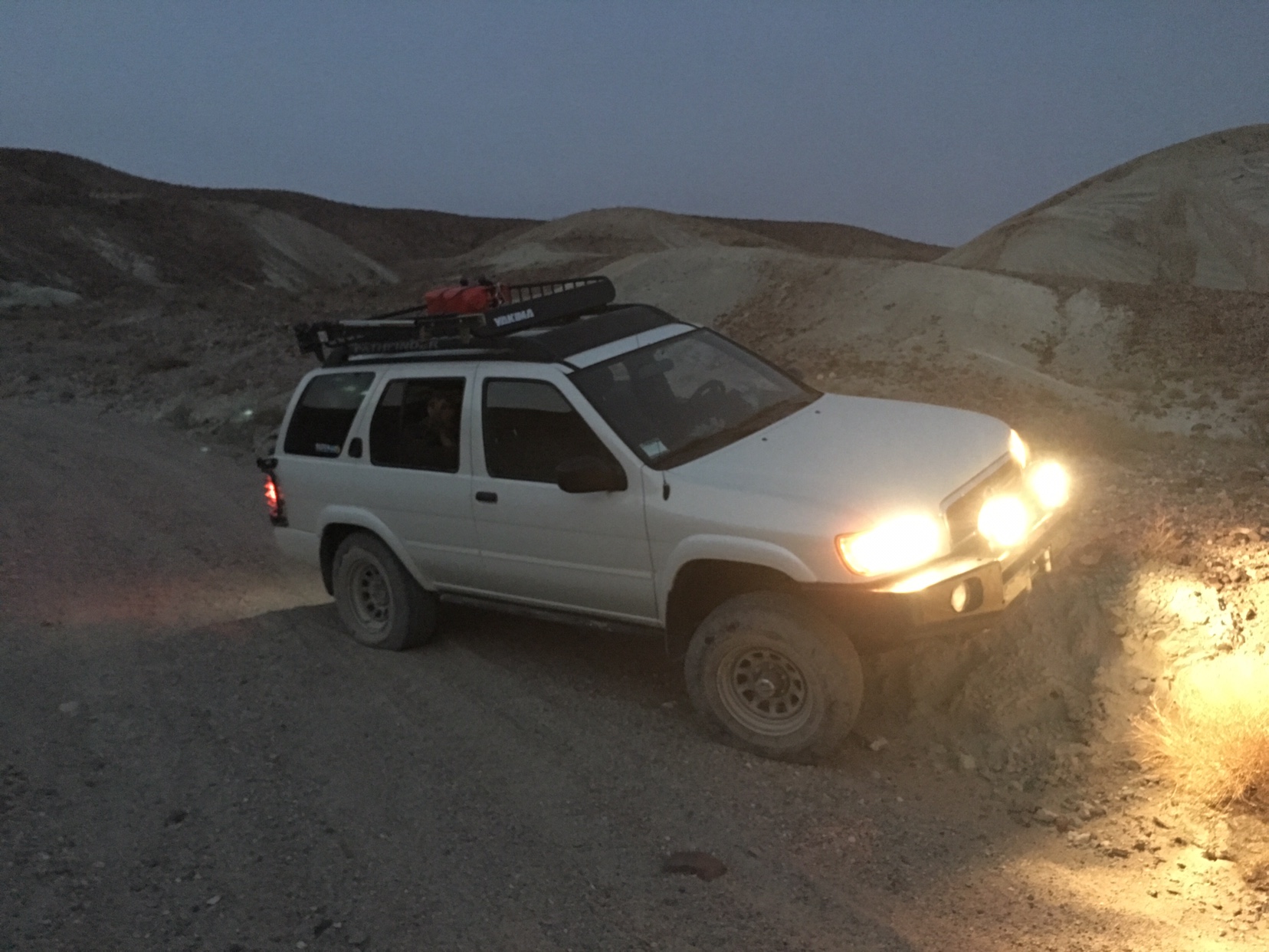

Shocks were worth every single penny. I’m beyond pleased with how well the truck ran the trail today. My main focus today was not to test my trail limits in terms of technical difficulty but to really test the shocks hard to find their limits.... rough/rocky washboards and uneven terrain was not a problem and definitely no longer will be when I’m over-landing.
Ran calico trails today between 25- occasionally upper 30mph runs on roads i would have previously taken at maybe 10- lower 20mph. I felt notable differences that instantly validated the $$ for the shocks and rear combo with the HD LR coils... absolutely love the set up and would recommend it to anyone whose considering to run bilstein 5165s and the HD LR 9448 coils. Again imo it’s worth every penny, I would have been bouncing around in the 5100s i had previously.
Went downhill/ straight, etc over terrain that definitely had some deep potholes or ditches that also gave the car some various basic flex terrain. I cant properly explain just how smooth the ride was, as if gliding practically. Took various corners at higher mph and the truck felt nice and firm all through out with no rear ended drooping or swaying (hats off to hawairish’s sway links). Trail time was just over 2 hours and the stocks responded well the entire time. 2 hours may not seem like a lot of time on trail but mind you it was practically a two hour stress test.

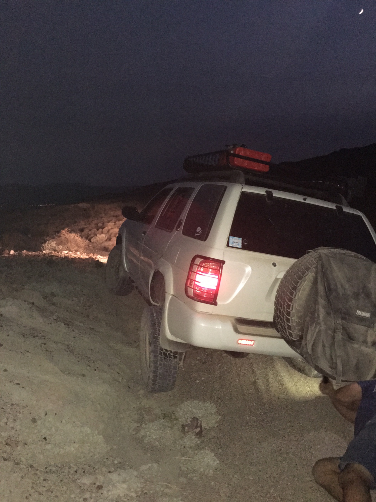

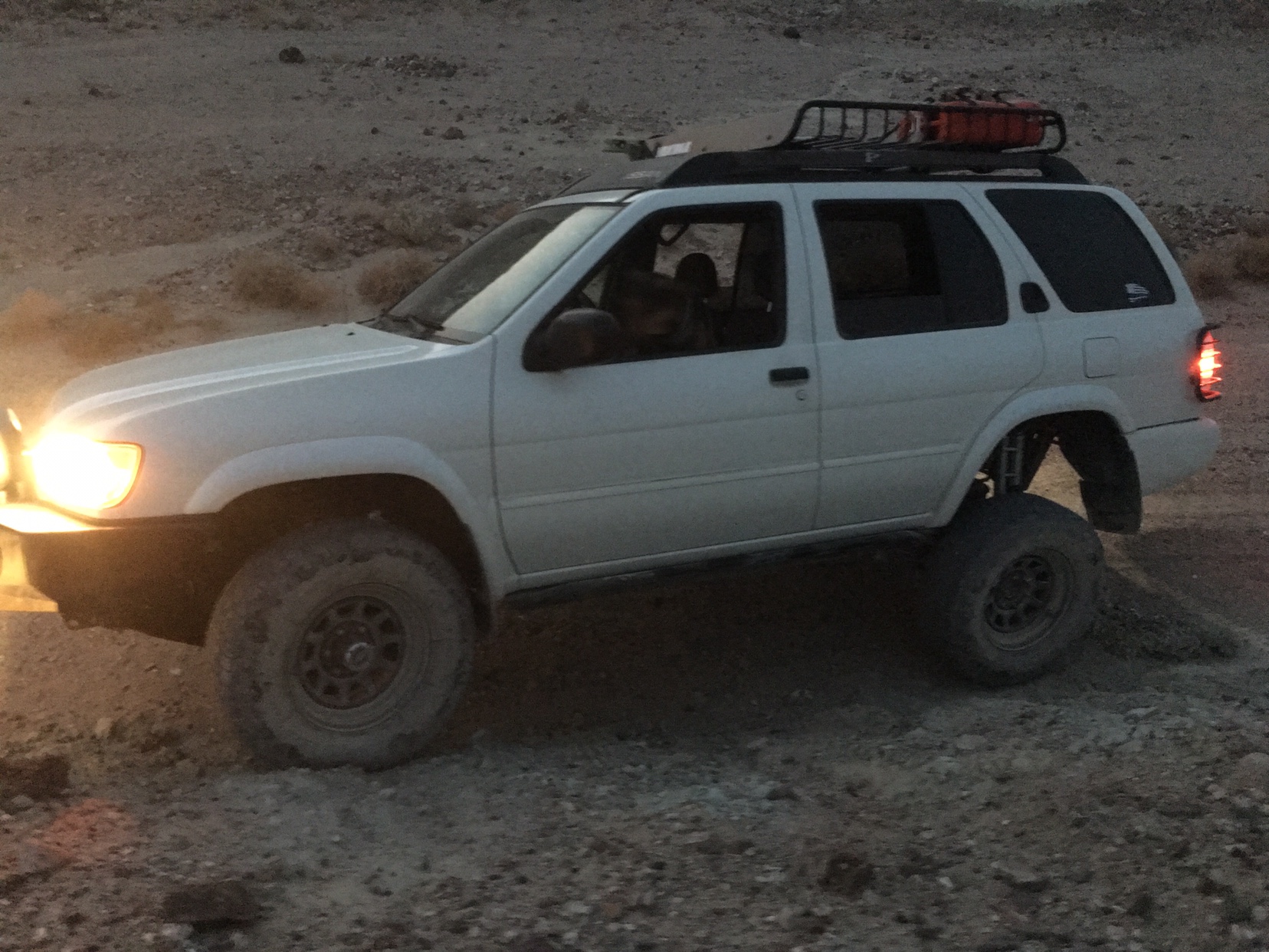

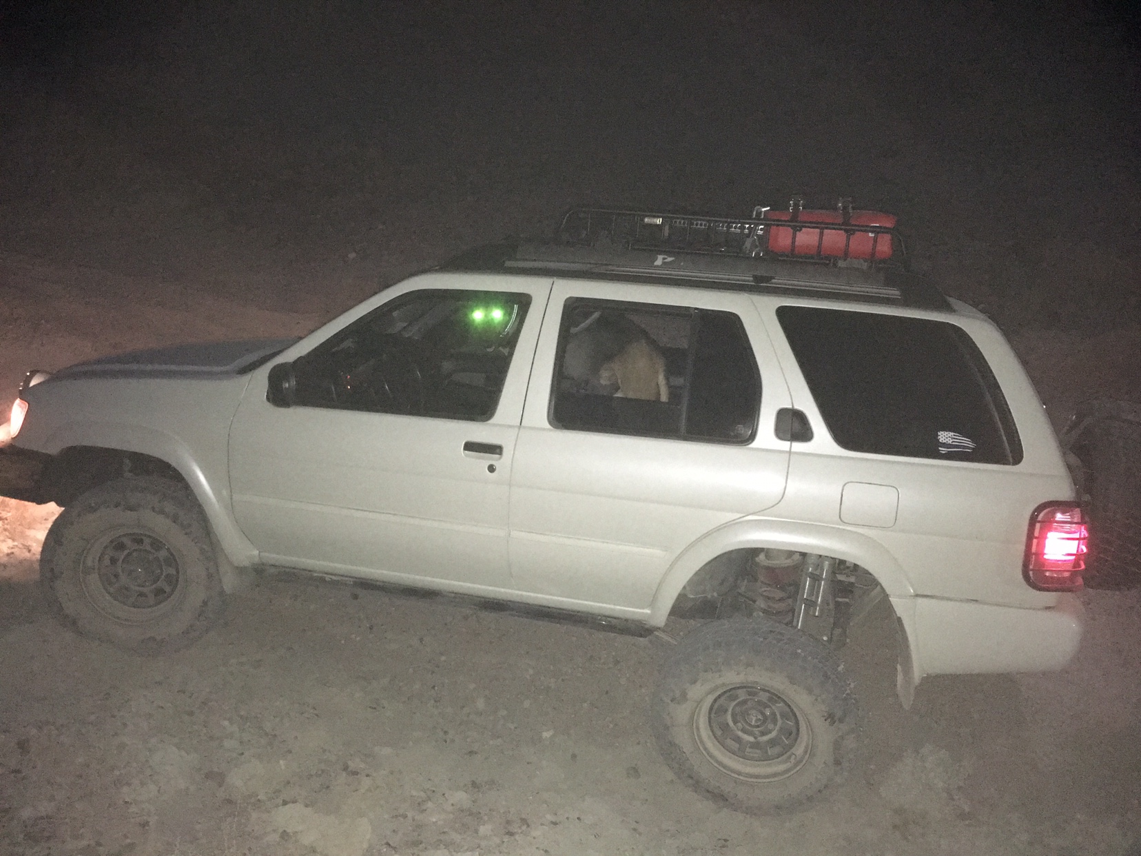

Now for the fun part

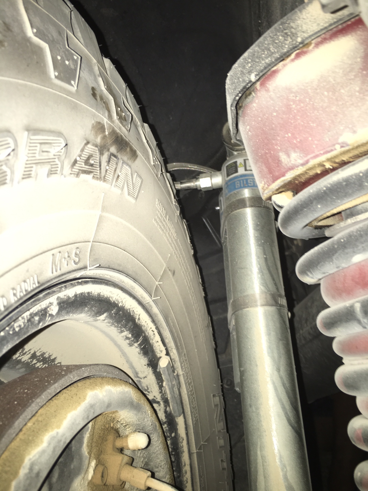

.......... the reservoir hose ...........
to save any searching for anyone wondering my part ## again
.......... #25-261400..........

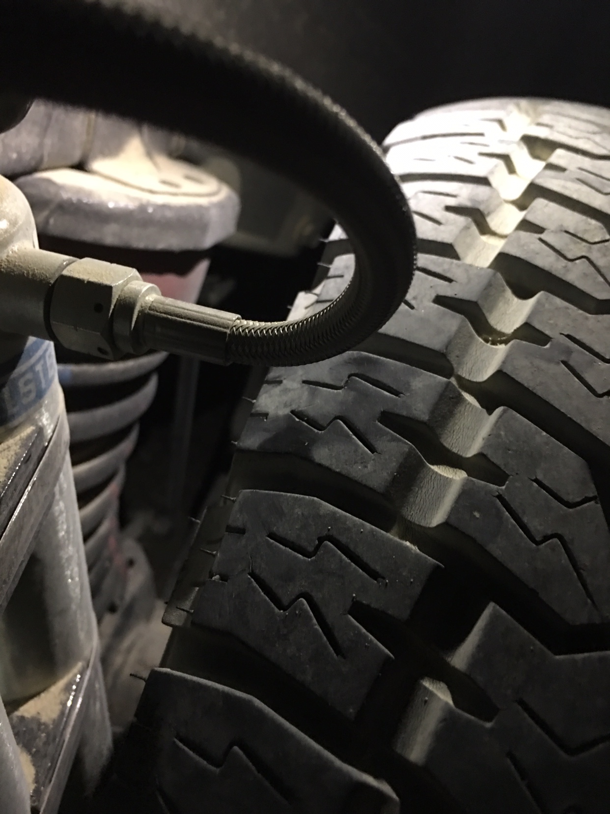

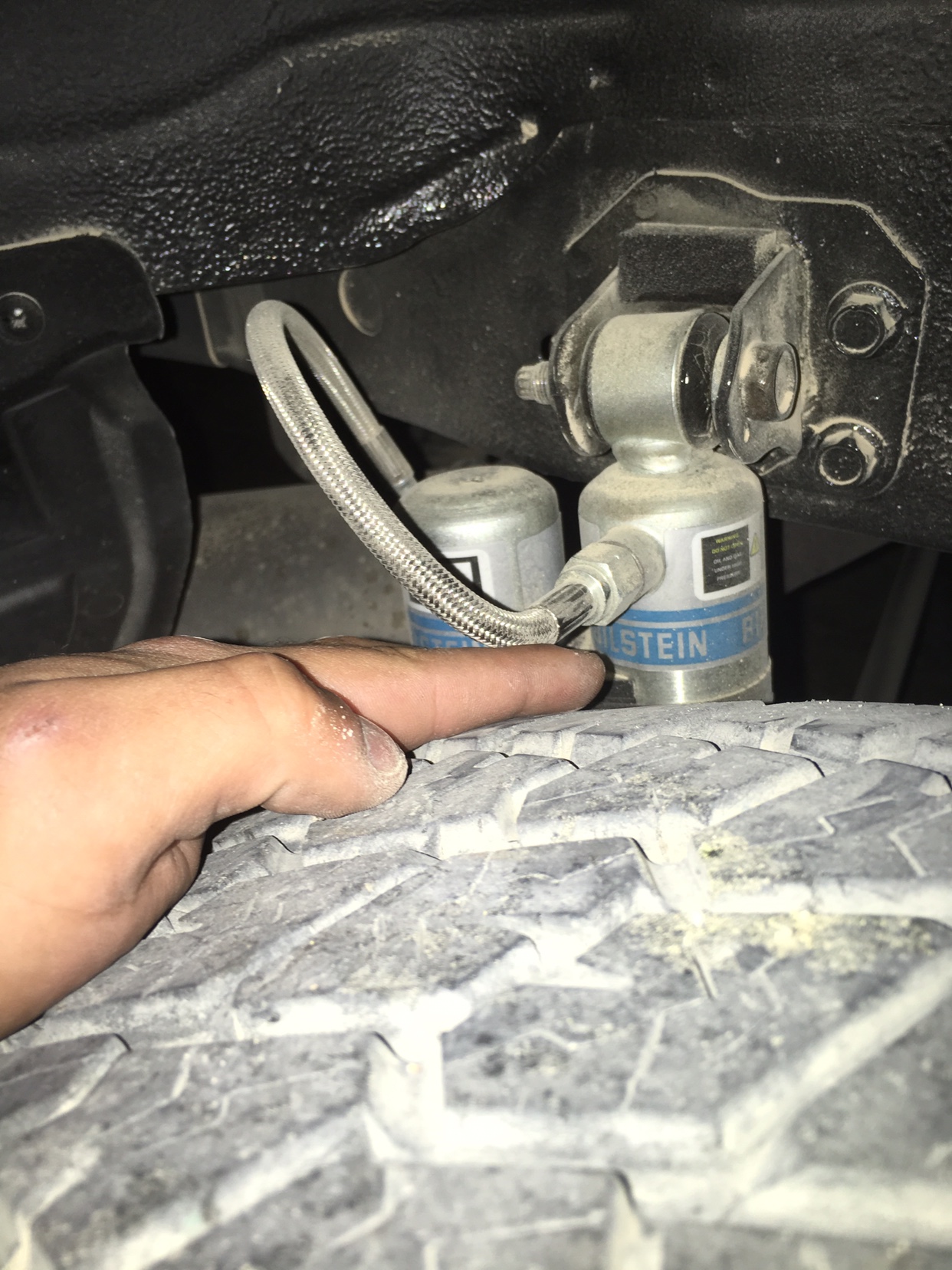

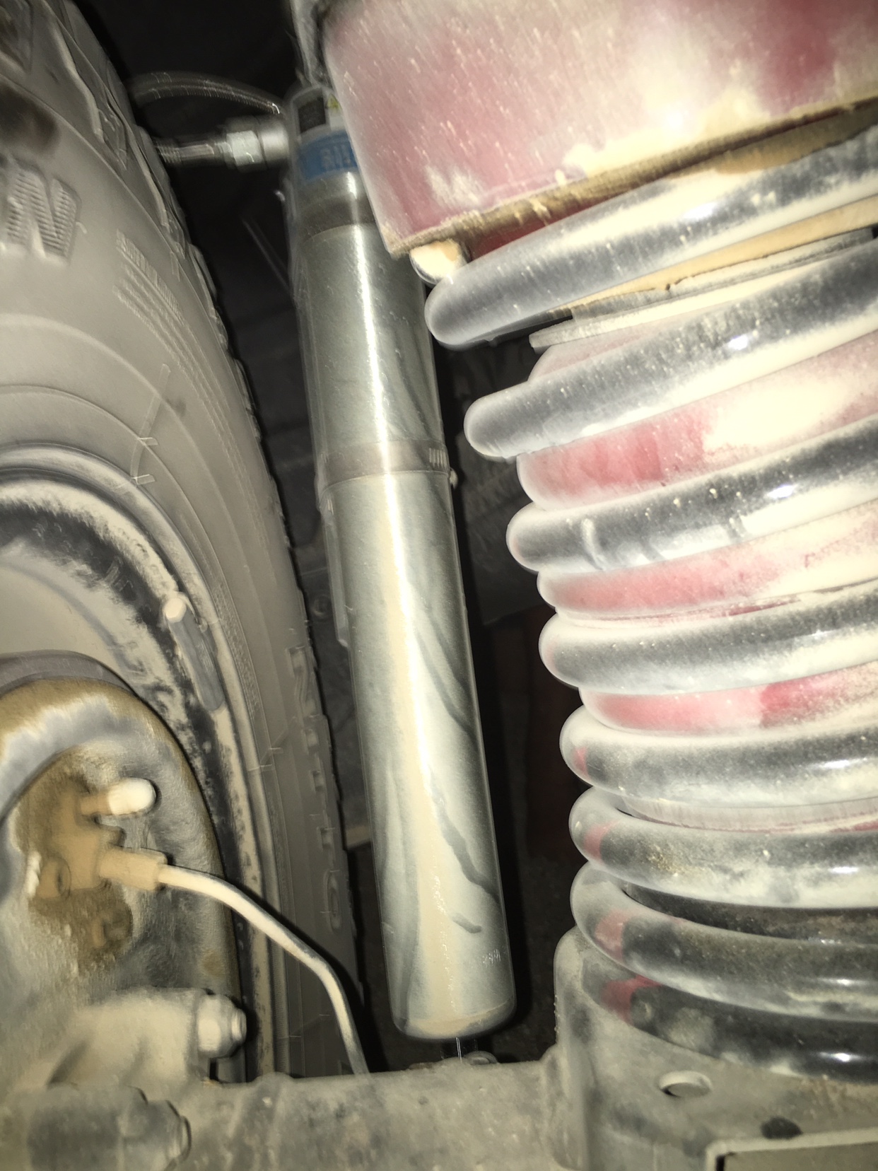

As we were initially worried ([user]hawairish[/user]). The reservoir hose will touch under extreme flex... pics to follow....
During these pics the hose did NOT touch. Never did the reservoir hose graze against the side wall this entire trail run. However in these following pictures I feel if i had added anymore flex, or me jumping in the rails, the hose and tire would definitely have touched. That’s just imo but I feel the pics justify that.
I apologize in advance for the annoyance and bombardment of pictures but it was difficult reaching certain angles and so I’d like to just give you a free for all of whatever i took. That way you can possibly see various angles and answer any questions you have.
IMG_1233.jpgIMG_1261.jpgIMG_1271.jpgIMG_1254.jpgIMG_1253.jpgIMG_1243.jpgIMG_1235.jpgIMG_1252.jpgIMG_1260.jpgIMG_1263.jpgIMG_1265.jpgIMG_1276.jpg

Imo that showed some pretty decent flex and the shocks still didn’t touch... however not saying they would not touch with active driving or rocking motions.
For those considering 5165s... [user]towndawgR50[/user] and I both ran into different issues where as his shock mount had to be relocated to accommodate longer shocks. My shock mount remained at the oem location and I ran the appropriate size for my 6in lift... the difference lies in our reservoir hose. Towndawg’s reservoir hose has a low profile 90 degree swivel while, obviously from pictures, mine is stationary and sticks outwards.
Our shocks are mechanically the same but yet structurally different in regards to the reservoir hose.
So why not just get a 90 degree swivel like TowndawgR50? Well bilstein designed 5165s for fords and various Chevy trucks whose mounts and shock lengths are different from our R50s. From my findings.. there are no 5165s with a 90 degree swivel that match the collapsed/extended length to fit the oem mount location.
Now bilstein sells a model ‘7100’ its a reservoir shock too and it’s rebuildable... i didn’t get that one because I don’t know how or plan to rebuild shocks. They may have 90 degree swivel hose mounts ?¿ I’m not quite sure as I didn’t do much reading on those but for anyone whose 100% diving into reservoir shocks, take a peak at those and let us know what you find please. It may or may not be a solution.

My 5160's were for an early 2000's Ford F series truck with a lift. I think if I had gone with a set that was for a less lifted spec it would have been perfect. Maybe bilstein can provide the flex line with 90° fittings on both ends by itself?
We'll get you setup@RainGoat. There has to be a model with the 90° fittings for that ride height. Might just have to contact Bilstein and ask.
Looks like you had a blast! Not too much smoke from the fires either?
We'll get you setup[mention=40800]RainGoat[/mention]. There has to be a model with the 90° fittings for that ride height. Might just have to contact Bilstein and ask.
Fires didn’t affect us much up by calico. I was thinking of swapping the fittings but that’s what brought me to mention the 7100 series because they’re rebuildable as opposed to the 5165s. I wouldnt see how to properly pressurize the shock once again after swapping fittings... again if swapping fittings was even possible.
I think mine was from a 2013.
Sent from my iPhone using Tapatalk
My 5160's appear to be rebuildable but im not sure how I would pressurize them  either. The shock body and reservoir have circlips on the lower side that are removable, and im assuming used for servicing. If anything they can be sent in for warranty service from Bilstein and switched at that time.
