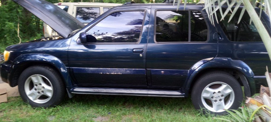

I bought my first Pathfinder on friday for 600bucks the 2002 Qx4's VQ35DE comes with "milky oil" & had been sitting, so It was delivered via towtruck (included in the price)-

First of all welcome, sounds like you have a lot of questions!  I'd advise you to just expect some feedback on the engine/tranny removal question here, and go ahead and start a new thread with the rest, where you can post updates and further questions pertaining to your Pathy, since this one is dedicated to system_f's rig!
