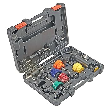

pressurize your cooling system with these tool and you will see leaks. faster.
Throw some dye in the radiator! You should find the issue quickly.
I'm not sure how this works? I'll google it and see what I find.
This looks advanced....
Fixing the problem is often easier than finding it! If I knew what was wrong with my brakes, they'd be fixed by now.
A UV dye would make the leak easier to find, provided it's somewhere you can shine a UV light on. People do the same sort of thing to find air conditioner refrigerant leaks. The pressure adapter means you can pressurize the system without warming up the engine, so the coolant that escapes doesn't just boil off. I'd be inclined to jerry rig something with a blow gun and a pressure regulator rather than buying a dedicated test kit.

I think you can also rent the pressure system tool at the auto parts tore as well...I could be wrong though.
