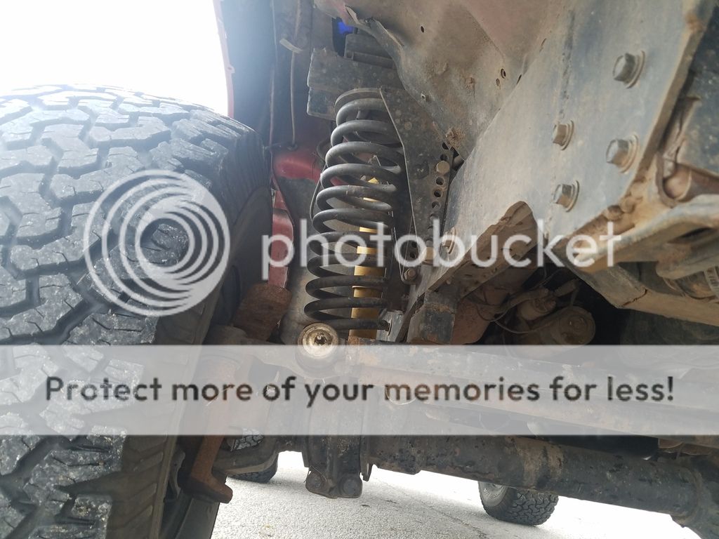

It's been awhike since I have been on here, recently acquired this 98 SAS Pathfinder with a very reputable build sheet....
This one has a SAS with a d44 out of a 79 bronco with Reid racing knuckles, arb air locker in rear, Tom woods front and rear driveshafts, Tom woods slip yoke eliminator, a 3.3 that is now a 3.4 with diamond racing pistons, and European racing cams, upgraded calmini 4:1 gears, 5 Speed manul trans, dual battery system with upgraded alternator that you can weld off of at 2k rpms, snorkel, 10 gallon fresh water storage tank.... the list goes on.

Very cool. If love to get more in depth info on the swap setup. Headed towards a SAS soon myself.

Is there a thread somewhere that shows the details of the SAS itself? After the short amount of time running the sfd/ac combo, im looking more into this.
