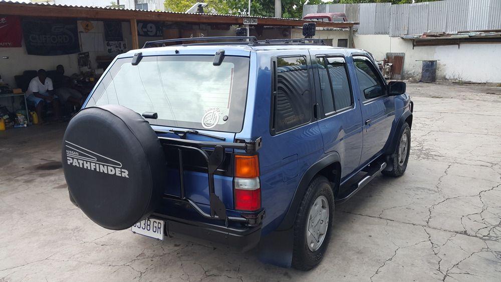

Hi guys, been a member since last year when I bought my van but this is my frist post. I want to say thanks for all you unamed souls for inspiring my build.

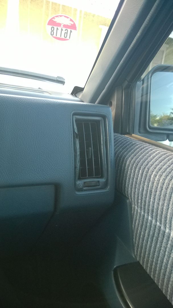

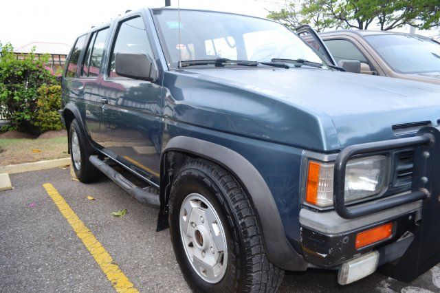

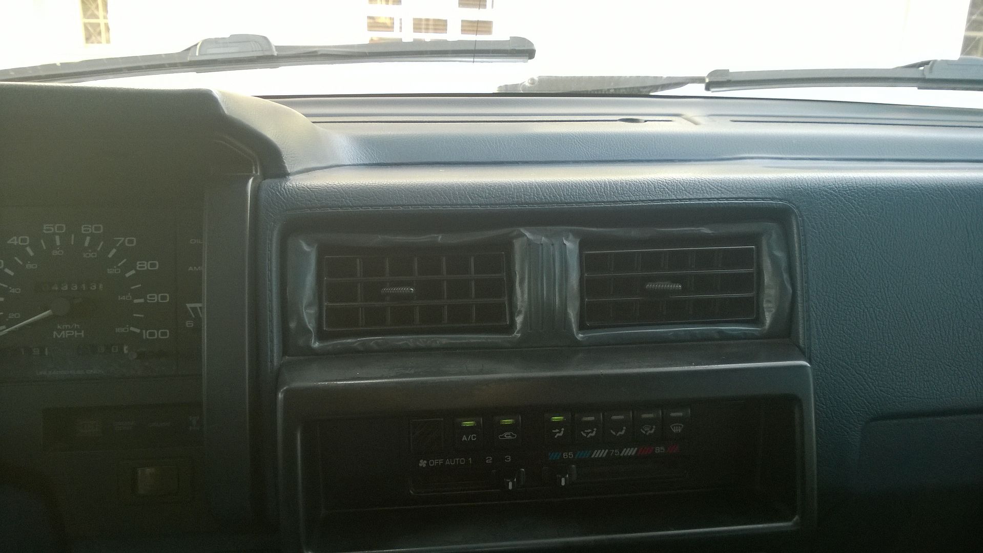

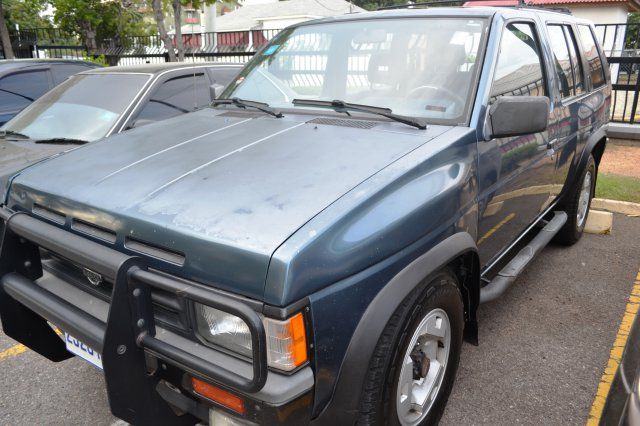

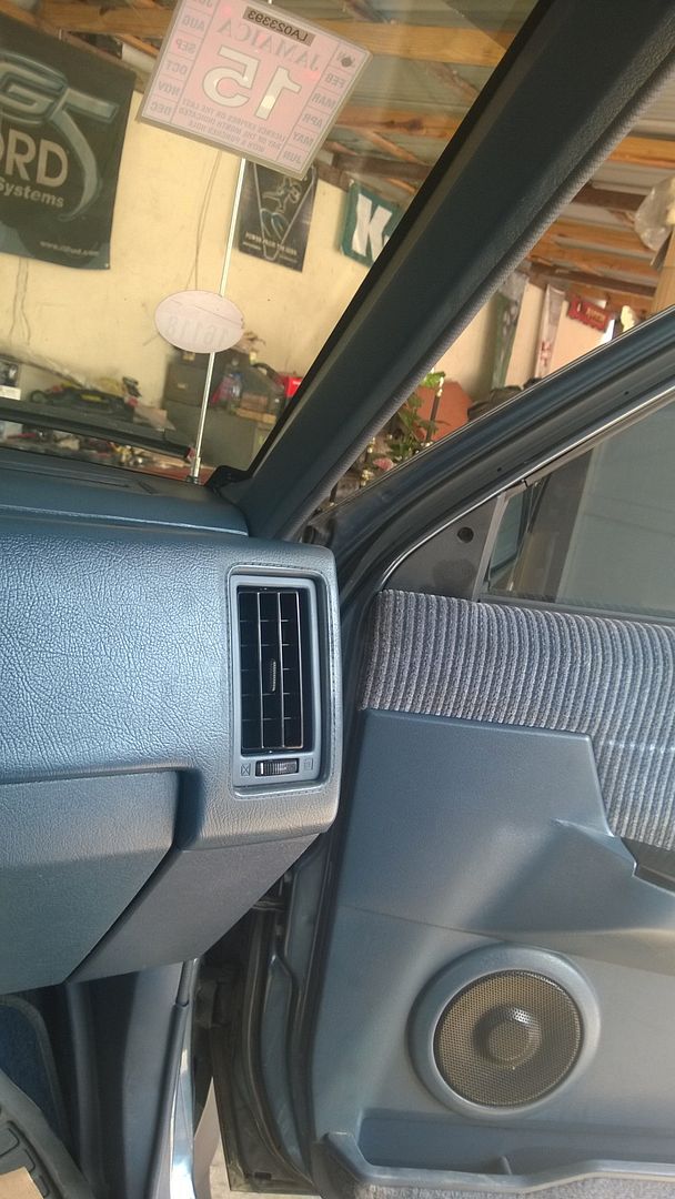

I call her Buggy, I found her last yearand beyond burnt out paint, she appears to have been in a time warp somewhere for the most part. 42,000 Miles, near perfect interior, besides a broken centre stack and some warped vents. All of that since replaced.
This is how I found her. The body is straight, no repairs
That gave way to this

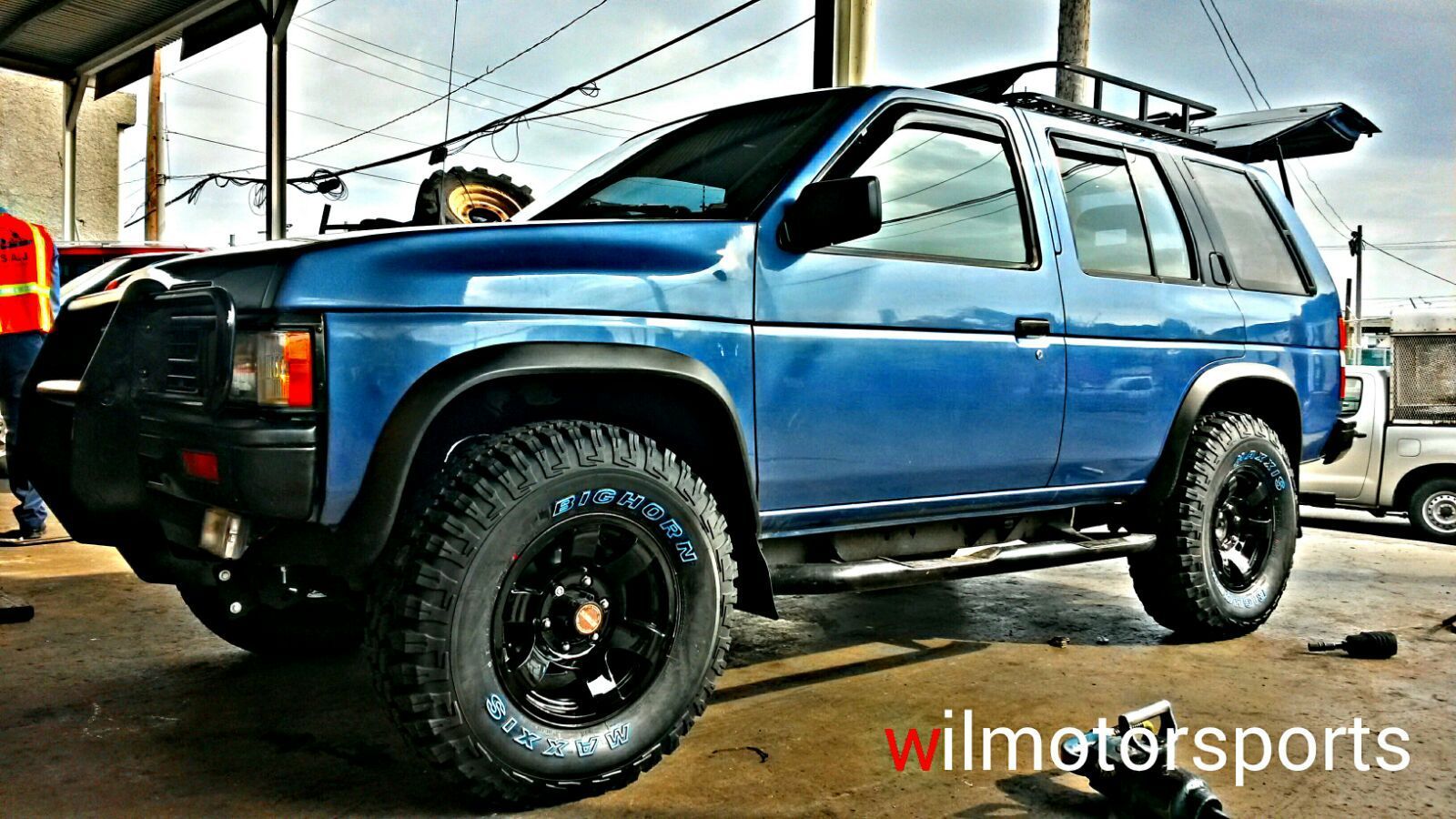

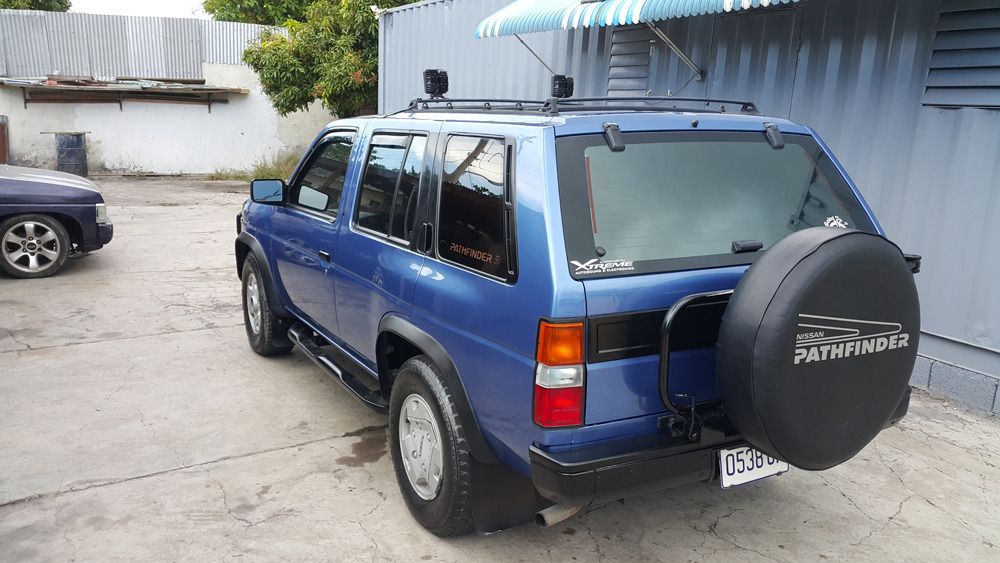

and now we're here: 3" body lift kit
Just missing that centre piece on bonnet, which is on order. It fell out after spraying.

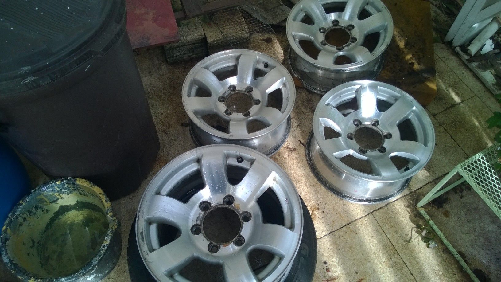

The rims are some used and cleaned up and sprayed over 16" Tacoma/4 runner wheels. Tires are 265/75/16 Maxxis Bighorns at 25psi, filled with nitrogen
that's dust on them

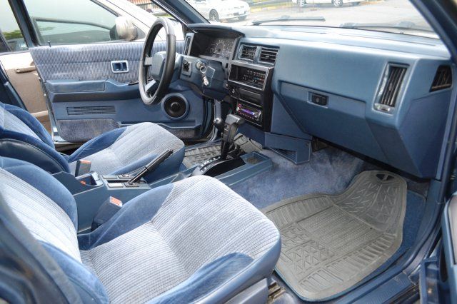

I saw it for sale at a great price and when I saw the pics I couldn't believe the condition, for a then 23 year old Pathy. These are the actually the sale pics and when I went to look at it, they were true. The paint was burnt out but the body was incredibly straight and free of rust or anything else. The interior was unbelievable. As I had mentioned, with the exception of heat warped a/c vents and a broken centre arm rest teh van was 100 complete and in what I think was great condition. It made me believe the 42,000 miles on the clock as original miles because the interior showed very little sign of use. The interior seats needed a good steaming but that was the least. Needless to say, I bought it on the spot.

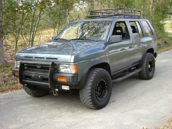

This Pathy became my insperation but others inspired me. I found as many pathy pics Google could find me. I wanted a little of everybodies. I'm sure some of yours made the list.

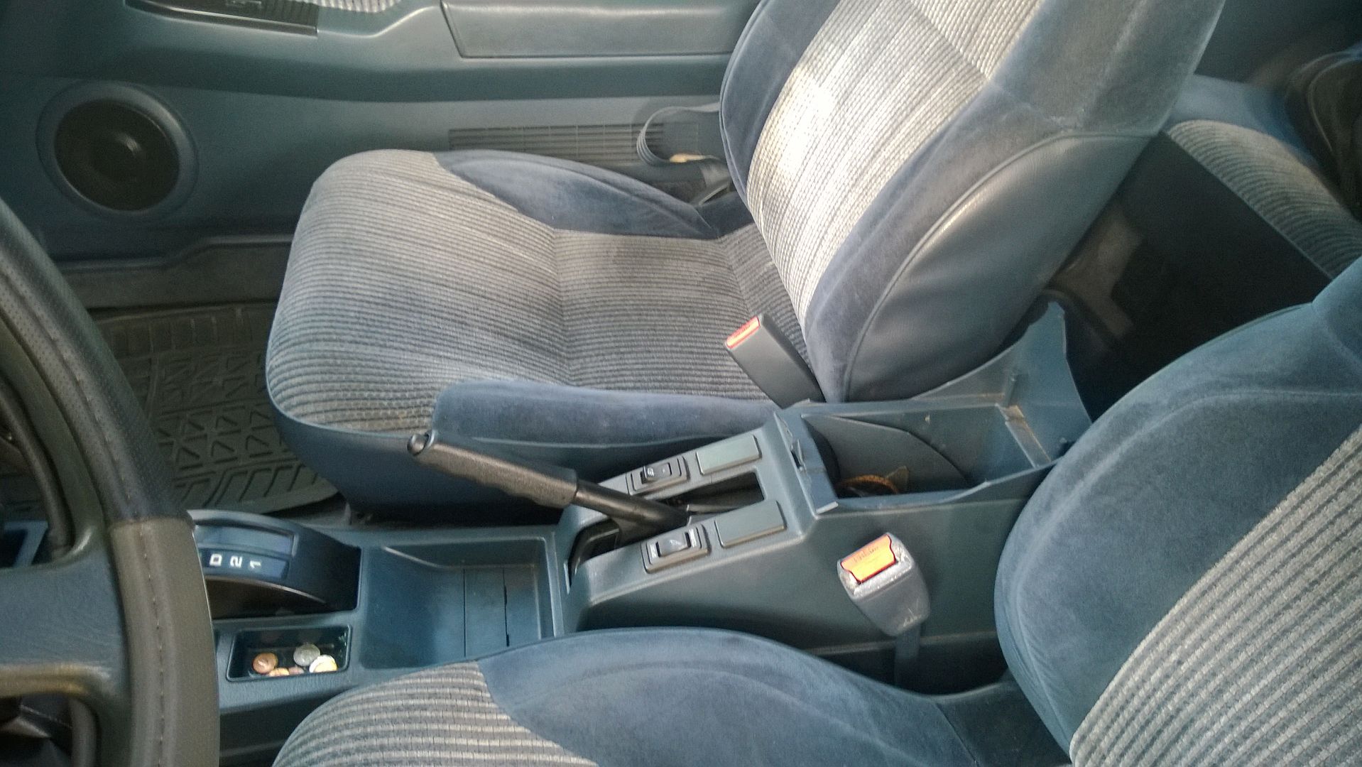

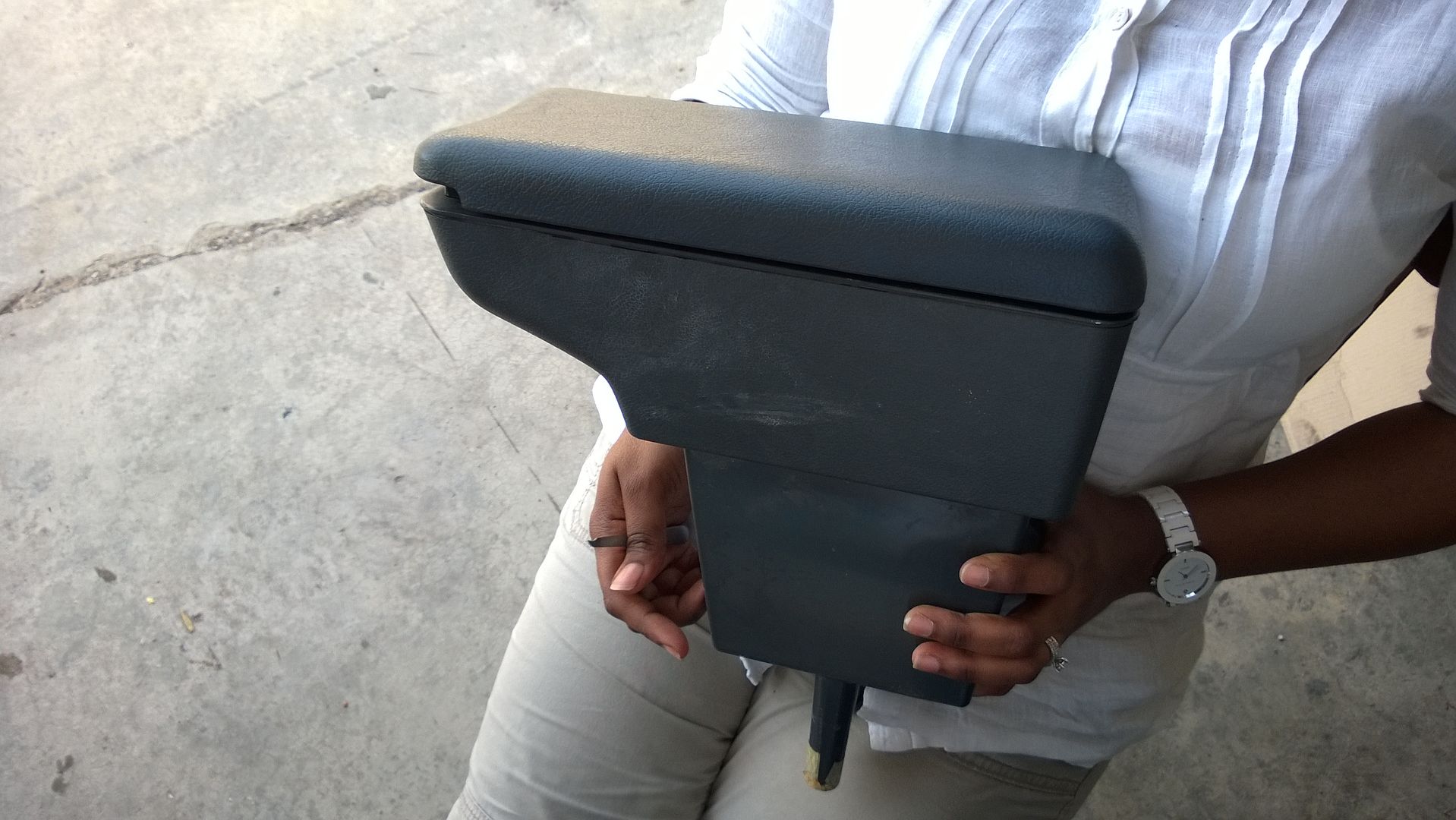

Center console top needed. The whole centre console new was $350us + shipping on ebay. I decided to try source one locally.

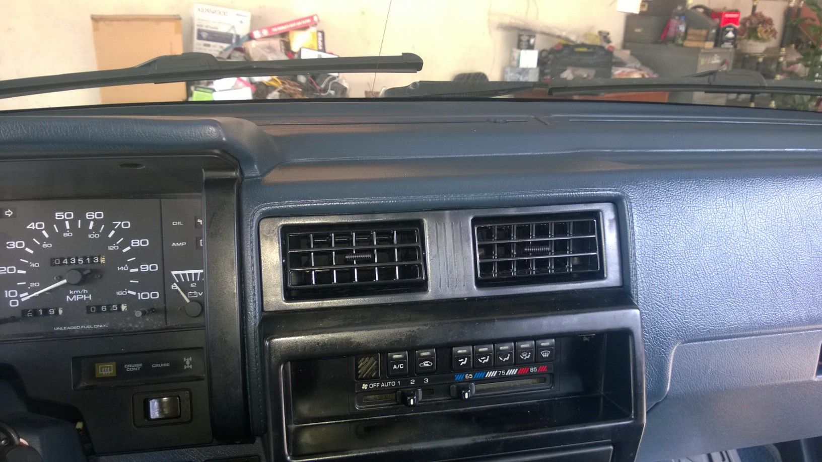

The dash was crack free except for one real small area

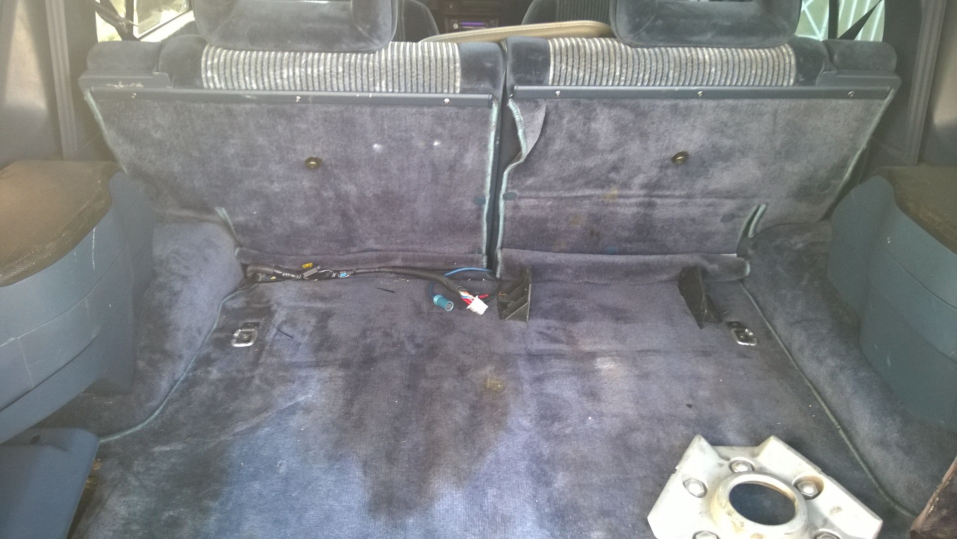

Forgot to post rear pic

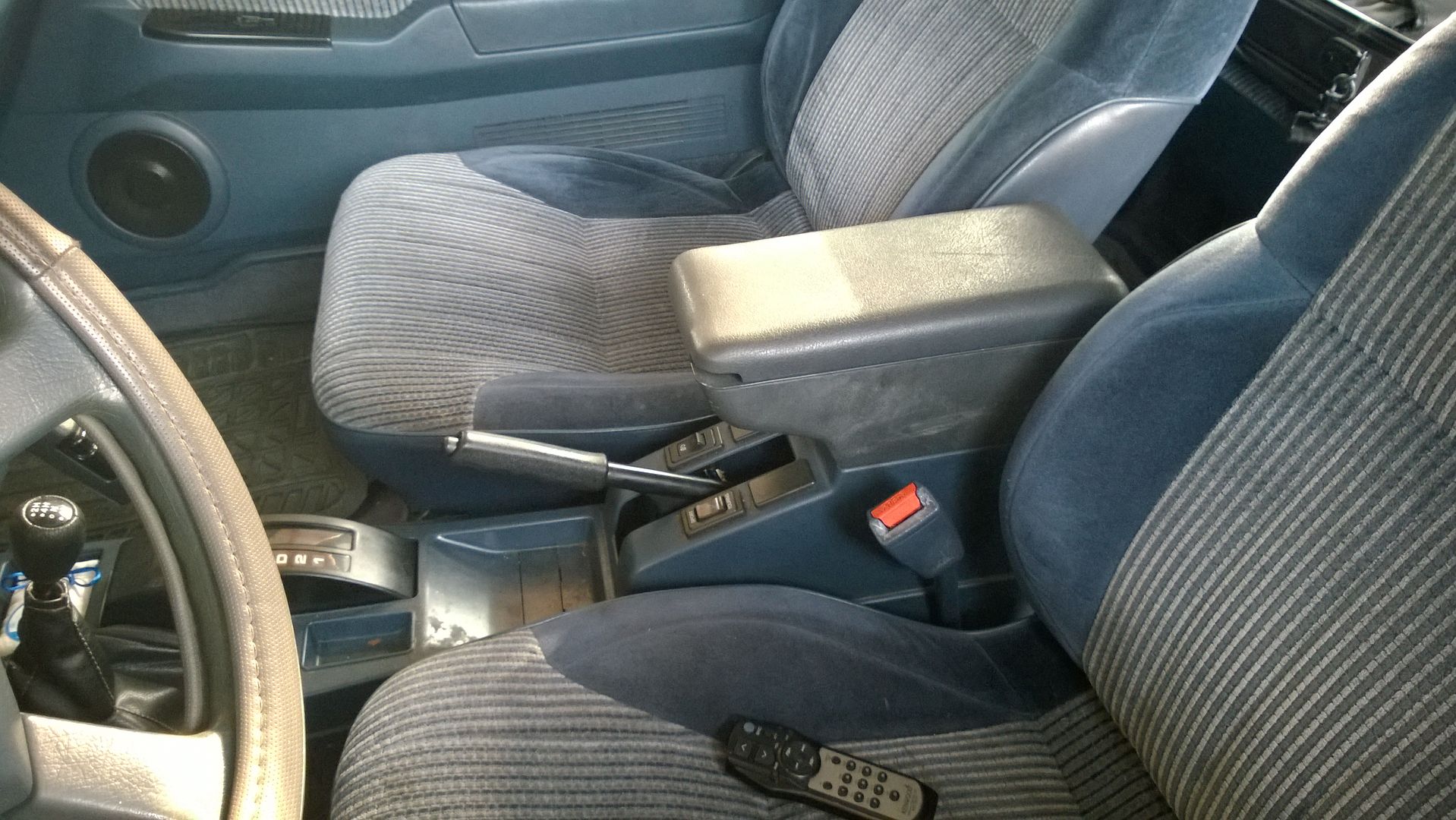

Luckly I found a new centre/center LOL... console. It really was only the top door that was broken so salvaged that from another piece and replaced the top
End result [2thumbsup]

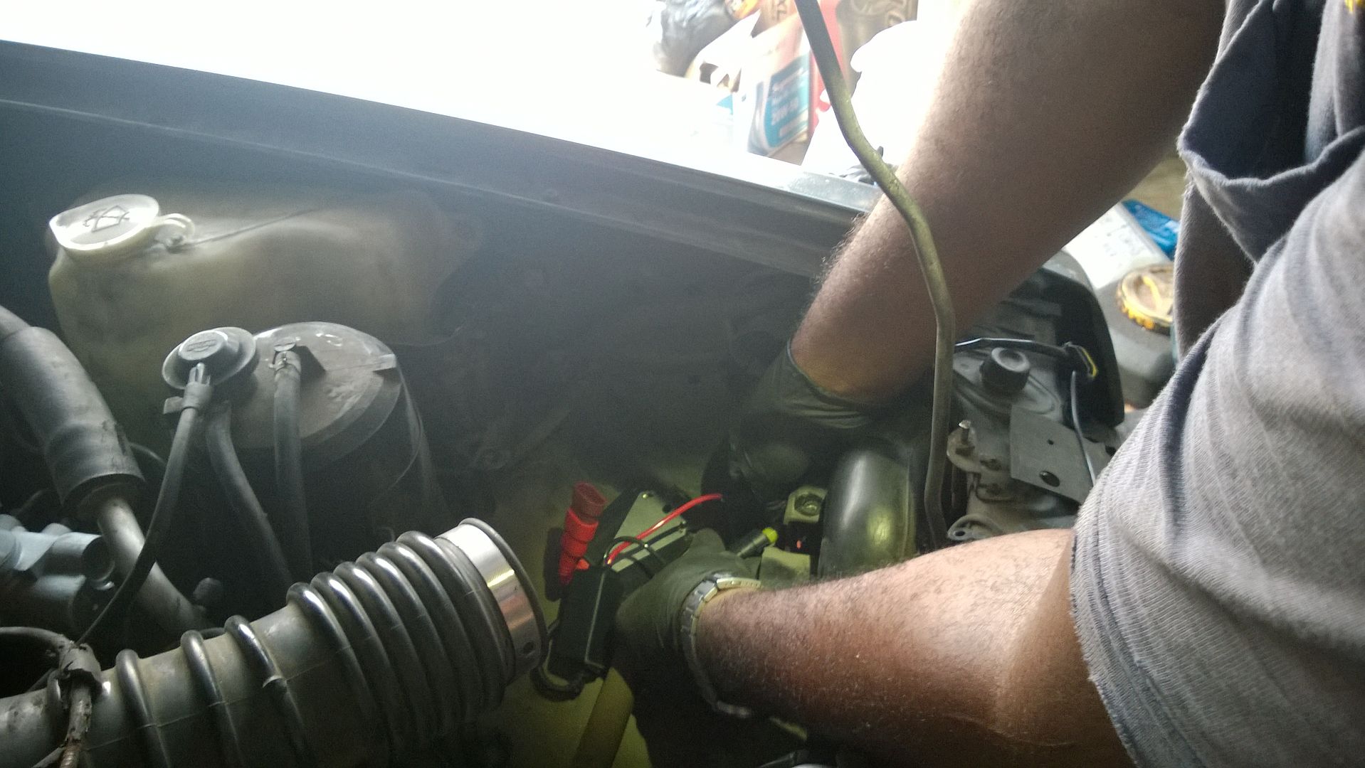

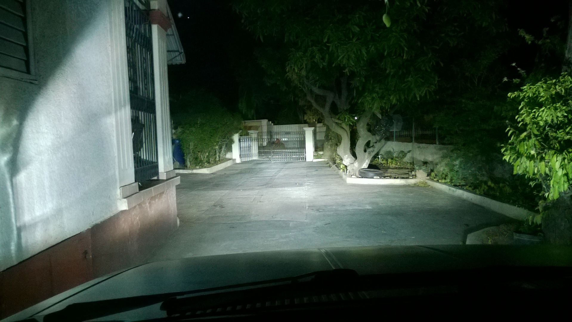

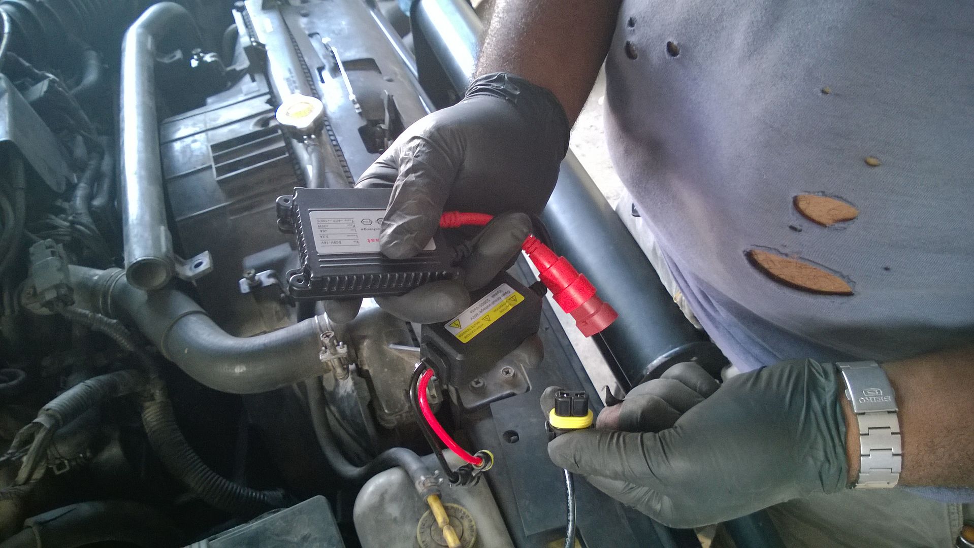

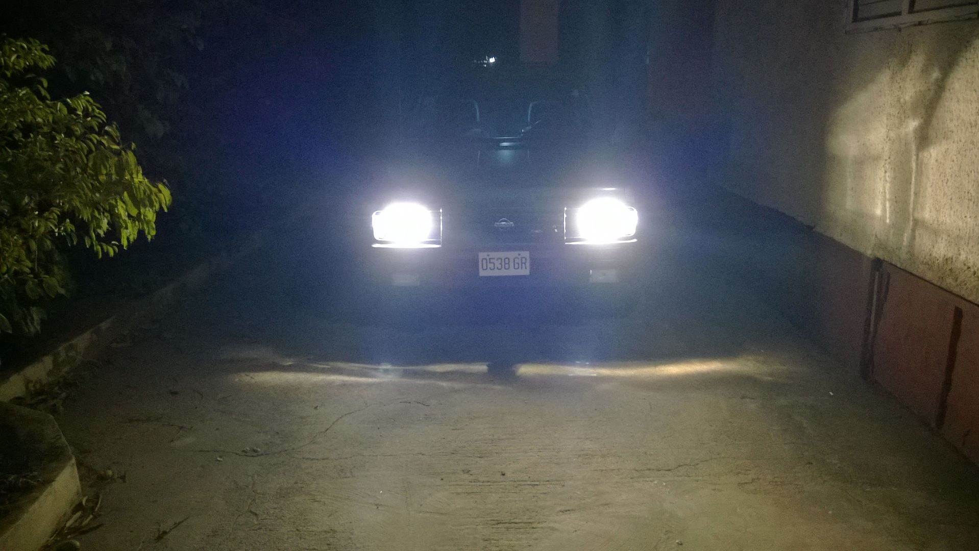

Now the HID was completely a spur of the moment wow decision. My guy sells the HiD Low & High bean conversion kit. He said it wouldn't take long to install, it really didn't, about 15mins... and the results are jaw dropping bright. I don't know if it's that Buggy's lens is actually old school and made from glass vs plastic but they are really bright in person. My pics will not do it justice. Probably the best investment in the project i've made thus far.

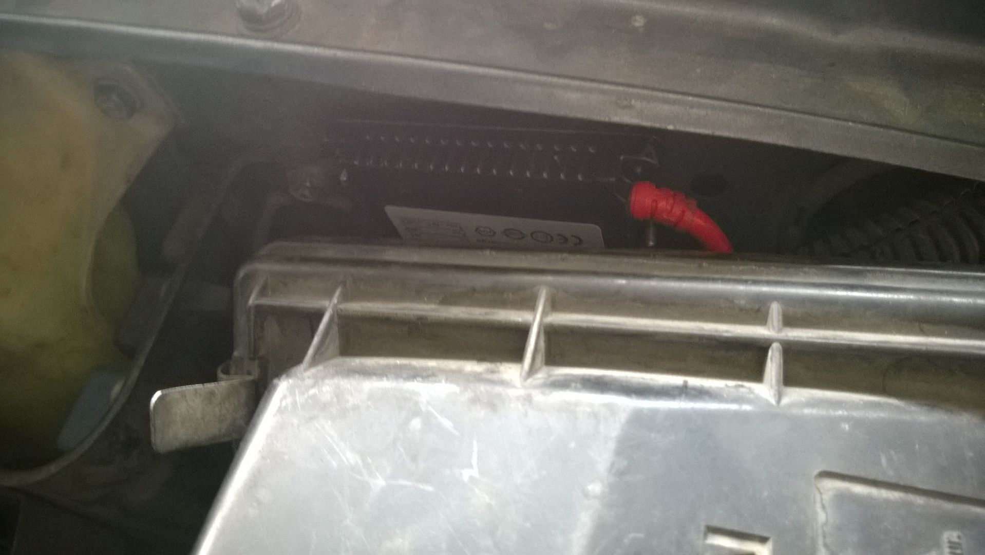

ballast neatly packaged behind air box
install on the other side

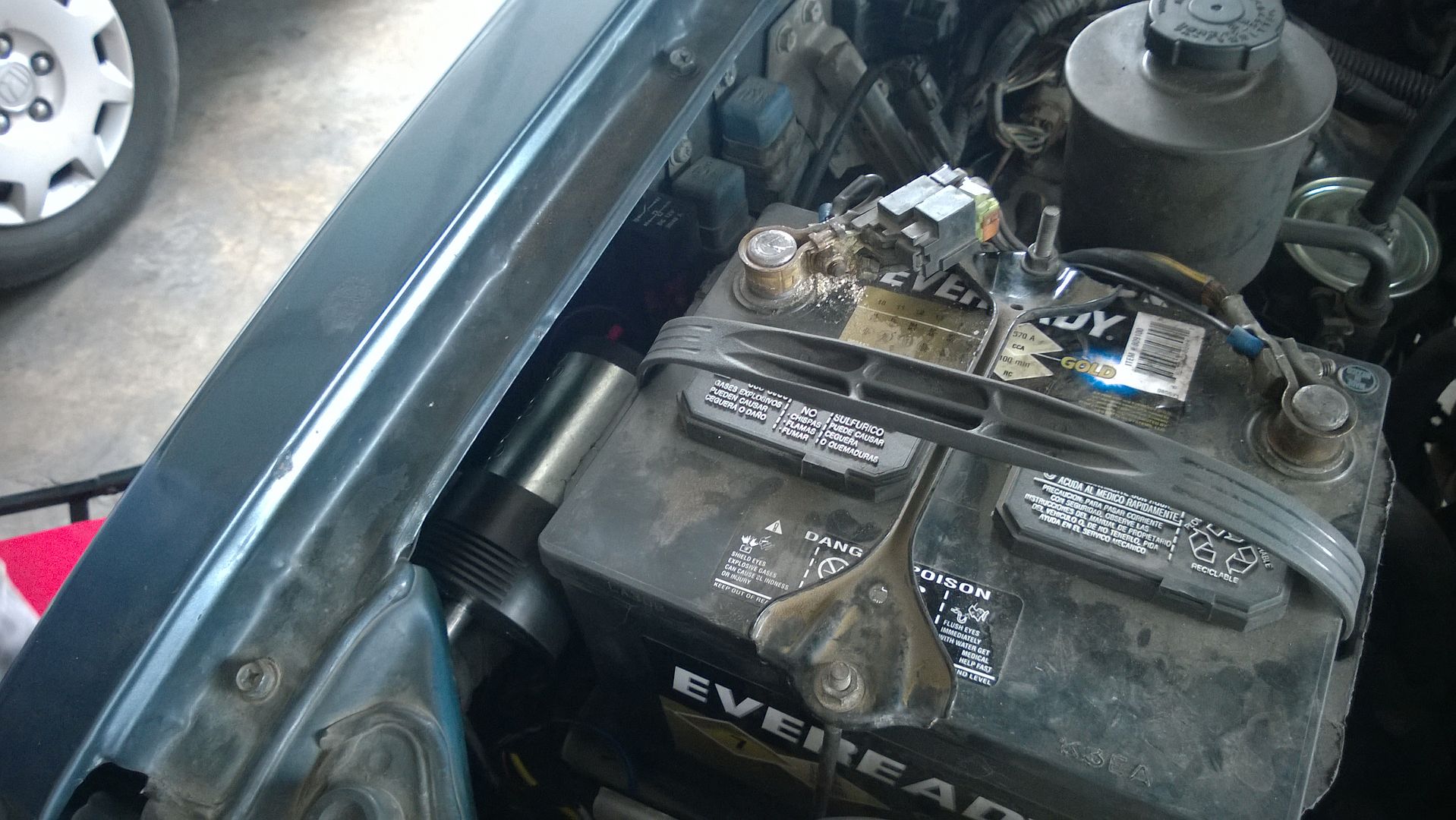

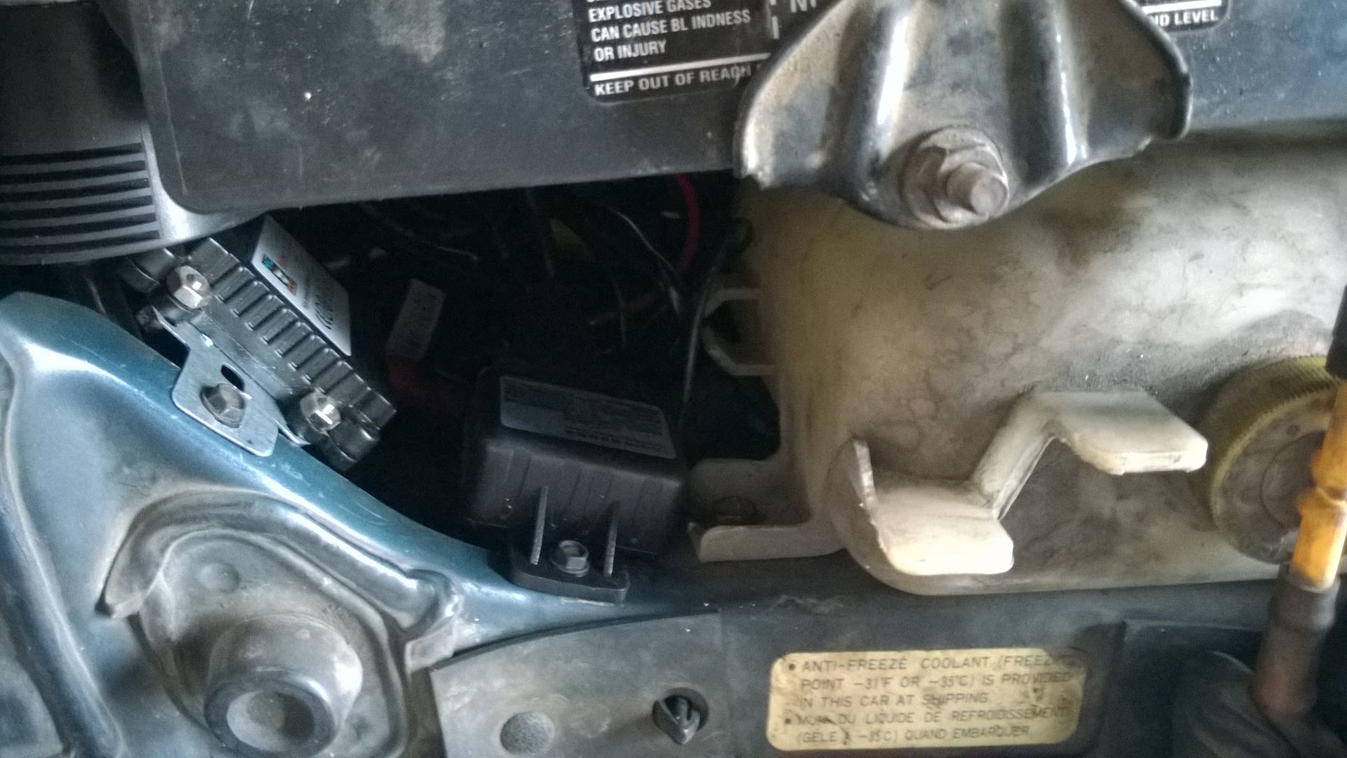

Put ballasts again neatly beside battery. Will have to get a longer coolant bottle run off however.

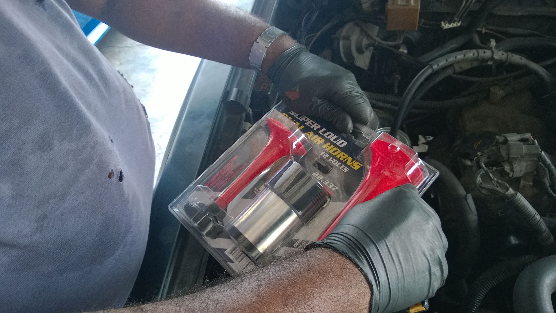

So with the part of the project finished where I replaced everything that needed to be replaced it was time to start added some funn stuff... beyond the horn,

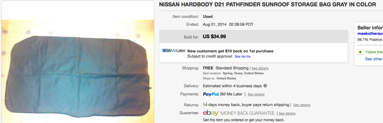

Bought an original sunroof cover, but have never used it

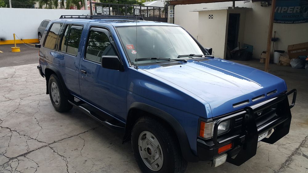

QUick break.. this is Buggy with my daily driver. The Wife and the weekend mistress. Have to say though... Now I prefer ddriving the truck to driving the car. It's a Toyota Marx X in case anyone is wondering. They look so good together. As you could tell here, The burnt out paint actually fit the old girl. She was my Old truck and it just added character to her.
