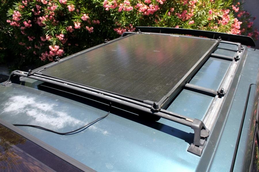

I have a solar set-up. I know this is an older post though.
Mounted on the roof, utilizing the existing roof rack, I have a Goal Zero - Boulder 100 solar panel mounted with brackets of my own design.
This feeds into a Goal Zero "Yeti" "Power Station" that I keep in the back to power various stuff.

Does it work well for you? Have you had any problems and would you do anything differently if done again?

I picked the Goal Zero - Boulder 100 because it was the largest panel that would fit in the roofrack. For that, I like this product. I can also remove it and set it up on it's stand. Or stand it up on my roof. It's built pretty tough, so it'll last for years being mounted, and dismounted, and used for camping, etc. For performance wise, not so much. I seem to be getting 40 to 60 watts regularly, and only on the best clearest summer day with the panel pointed directly at the sun, can I get something in the low 80 watt range.
Because it's powering a Goal Zero Yeti 400, I sometimes need more power, as I don't have much in reserve. So to get more wattage out of the panel, I loosen my mounts, and stand up the panel. This probably wouldn't be needed if I had more batteries connected. (Which I've ordered).  The Yeti 400 (non lithium) is a 300 watt inverter on a 33ah battery, so if I'm using a laptop, running a 12v fridge, charging phones and cameras, I can drain the thing entirely while working in the sun in something like 4-6 hours. doing the math, you can use 100 watts for 4 hours "400 watt hour" is the rating of the Yeti 400. So even with 40-60 watts coming in, if I'm pulling 180watts, I'm running out of power in the day time. But that's kinda heavy use working on the road.
My rack mount? Isn't the best. The first one that I designed would have been AWESOME, but became cost prohibitive. But I still want to make it. So for the time being, I bought some angle Aluminium and by making several cuts, bends, and holes, it works for mounting the panel. So I spent about $40 instead of hundreds. However, the location of the roof struts are critically dependent to be placed at exact locations for these brackets to connect and mount up.
