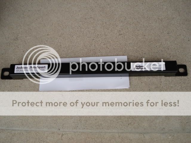

Came across this item a while back after a friend and fellow R50 owner had this installed. He raved about the noticeable difference in terms of improved body rigidity and torsional stiffness.
I called Jackson Autosport and asked if they had extra. Went and picked one up last week ($40CAD+tax), and installed it myself in about 10 minutes.

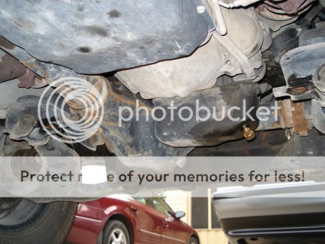

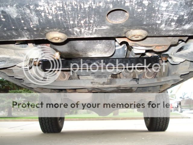

Here are some pics of the install:
Where the bolts are removed is where this stress bar mounts up (penetrating fluid may be required).
Mounted up and ready for action. I torqued the bolts, took it for a quick spin and retorqued again.

That looks interessting... I always wanted to put something there to better support my mid skid... Do you know if it drops lower than the sub-frame or the transmission crossmember ?? If you could take a picture with a ruler or long bar going from the sub-frame to the trans cross member, it would show how far it drops... like a straight line longitunally

damn thats genius. i think im gonna make my own tonight. seems like a pretty simple design. straight bar with 2 tabs welded at the end right? (from what i can tell by the pics)
I didn't picture (trying to hold a yardstick and a tape measure required both hands) but going longitudinally, there's ~5/8" of clearance compared to the tranny crossmember and the subframe. Definitely enough room to work with a mid-skid. :aok:
