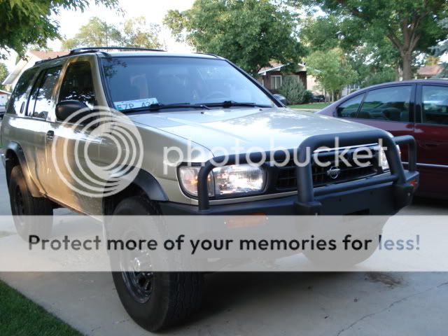

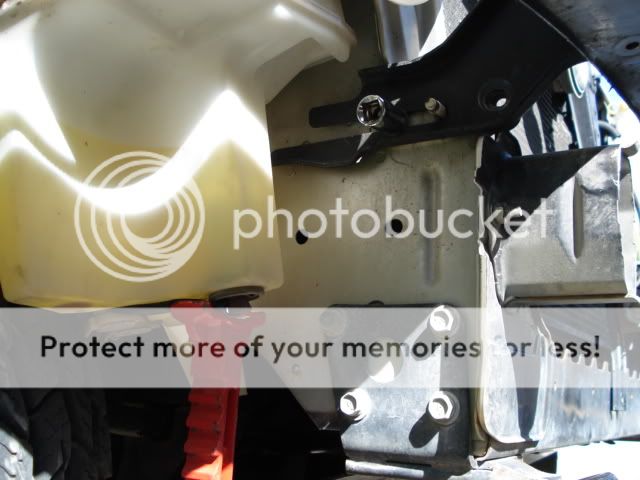

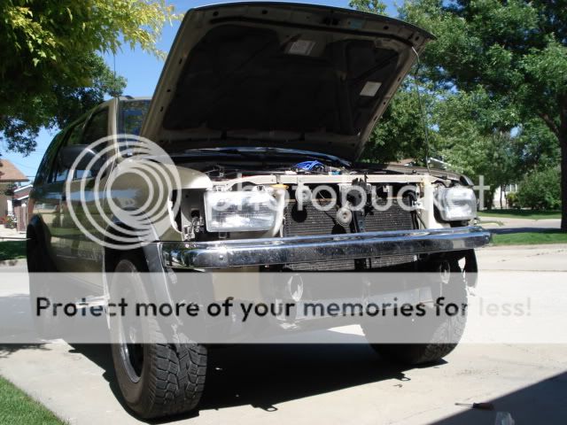

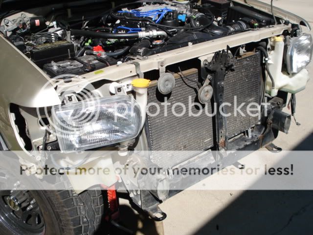

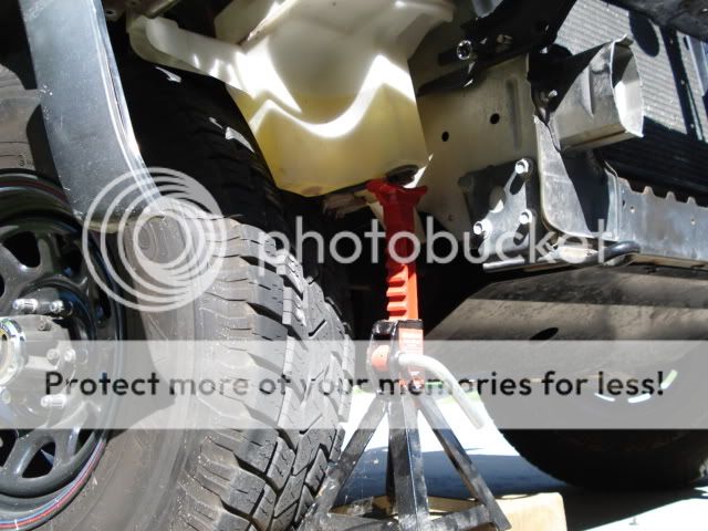

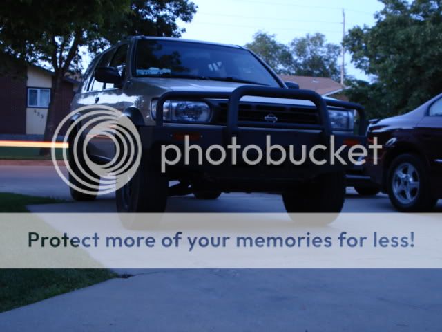

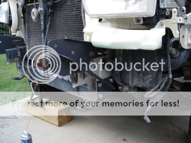

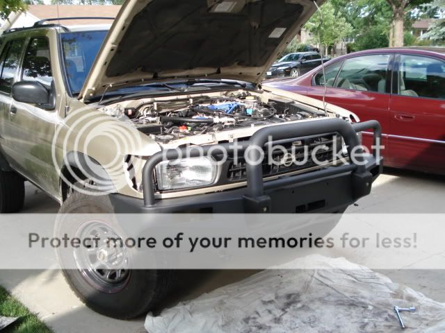

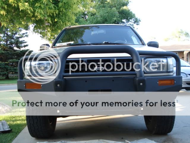

tekazgtr1984 Posted July 21, 2009 Share Posted July 21, 2009 (edited) Here's the install for the TJM T-15 R50 steel bumper. Spent a wonderful, sunny day working on it while enjoying beer and football. The only thing missing would have been two foxy women in bikinis suntanning on the lawn... Oh well. Started off by removing the fender splash shields, lower bumper and rad grill. Seeing as how the fender splash shields cover up a fair quantity of important stuff, I'm going to be spending the coming weekend cutting them so they can be remounted to cover aforementioned important stuff. Used jackstand to hold up washer fluid tank while accessing bracket bolts. Close-up of OEM bumper bracket. Pretty flimsy... Top bumper (plated chrome) removed. TJM mounting brackets ready to go! TJM brackets installed! Bumper mounted, bolts tightened. Left-hand LED turn signal good to go. And voila. Ready to bash sh*t up! Night shot really brings out the dark accents of the R50. Thanks again for the armor, Dan!!! Edited July 21, 2009 by tekazgtr1984 Link to comment Share on other sites More sharing options...

beavis0076 Posted July 21, 2009 Share Posted July 21, 2009 By far the best looking R50 bumper. Nice! Link to comment Share on other sites More sharing options...
OldSlowReliable Posted July 21, 2009 Share Posted July 21, 2009 i digg it, but those bull bars look kinda outta proportion.....still more than i got! Link to comment Share on other sites More sharing options...

tekazgtr1984 Posted July 21, 2009 Author Share Posted July 21, 2009 i digg it, but those bull bars look kinda outta proportion.....still more than i got! It looks a bit huge in the pics. From the right angle, the dimensions suit the R50 perfectly. Looks good Ty. Thanks. Now a subframe drop, 33s, rear armor, sliders, roof rack, lockers, air, and QD32ETI... Looking good Ty. Good to see that bumper back in Canada. I do wonder, however, how many trips that thing has made across the border, not to mention it's initial trip from Oz. It won't be doing any long distance travelling soon, unless it's with the R50. Very nice! Have you considered leaving the splash shields off and just using a bedliner on the fenders instead ? I'm planning to do that since the splash shields are very flimsy and can interfere with the tires. Only section where I may leave it on is the windshield washer fluid... Or I may just remove that anyway since I Rain-X the windshield regularly and never really use the washer fluid... Bedliner's already been applied, per the PO. For the shields, I'm simply cutting the lower portions and re-using the upper sections to cover the airbox and washer fluid tank. What I'll be reusing won't interfere with the tires. Buttercup? Lemon meringue? Is that the best you got? Link to comment Share on other sites More sharing options...
Pezzy Posted July 21, 2009 Share Posted July 21, 2009 For the shields, I'm simply cutting the lower portions and re-using the upper sections to cover the airbox and washer fluid tank. What I'll be reusing won't interfere with the tires. That's exactly what I did. Buttercup? Lemon meringue? Is that the best you got? TART! Link to comment Share on other sites More sharing options...
