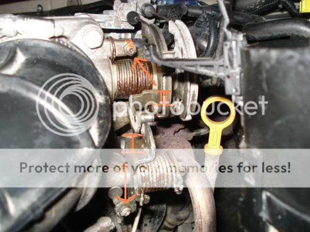

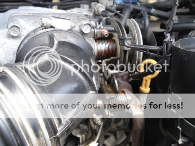

tekazgtr1984 Posted May 17, 2009 Author Share Posted May 17, 2009 Here are some pictures I just snapped: I) Corroded TB butterfly spring: apparently not causing an issue because the butterfly still functions as it should. II) Corroded temperature regulator cam spring: most likely the causing the high idle issue. Methinks it's time to find that fabled QD32ETI. Link to comment Share on other sites More sharing options...
Precise1 Posted May 17, 2009 Share Posted May 17, 2009 Either that or buy a new spring. Then there is used... *hint* Parts for Sale section, look for 'R50 parts'... B Link to comment Share on other sites More sharing options...

tekazgtr1984 Posted May 19, 2009 Author Share Posted May 19, 2009 Thanks for the suggestion but I know for sure it has to do with hardware being out of whack. Perhaps I nudged something when I was cleaning the TB, I don't know. All I know is the temp. reg. cam spring needs readjusting. How I go about doing that is still beyond me. Link to comment Share on other sites More sharing options...

tekazgtr1984 Posted May 20, 2009 Author Share Posted May 20, 2009 Thanks for the info. I'm pretty positive it's just the hardware. On the TB temp. reg. cam, there's a fin with two notches. At cold and hot, the notches don't line up with the TB pin. So my guess is the hardware needs to be readjusted or replaced. I'll check out my TB sensor, too, just to make sure. Link to comment Share on other sites More sharing options...
tekazgtr1984 Posted May 21, 2009 Author Share Posted May 21, 2009 So I was able to fix the issue and idle is back where it should be (~750rpm) but I am still going to go forward with new TB hardware and get a Nissan mechanic to calibrate everything. Link to comment Share on other sites More sharing options...
tekazgtr1984 Posted May 21, 2009 Author Share Posted May 21, 2009 These two screws are what help fine-tune the idle. So I adjusted the bottom one ( I ) while the engine was running, and played around with it until the idle sat at 750rpm. I double-checked everything, took the rig for a spin around the block and now it's all good. I'll let it cool down and take it for another spin later, to see if any further adjustment is needed. Link to comment Share on other sites More sharing options...
