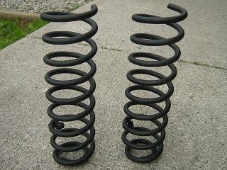

Just want to tell everyone about the JGC coils I got at the local JY. It seems everyone say v8 models is where to get them but I found
yellow tag .560 inch coil thickness part number 52088362 FN got them from a 6 cyl Grand Cherokee Limited. hope they work for me.
Just want to help the ass sag and stiffen it up some with a little bit of lift. Going on 95 SE with tire carrier and trailer hitch.
