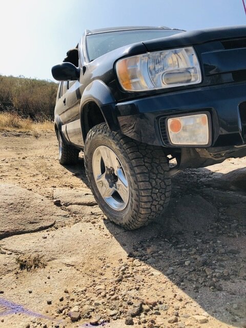

  4. So what I did was to gain clearance in the front end as a (no budget currently) starting point. I trimmed the front bumper in this case for function and to get it towards the look i'm going for. I appreciate the styling of the pathfinder of the same year but the front bumper on the qx4 hung super low and wasn't attractive to me. I also want a winch and a simple bumper that I might build or have built. I don't have experience building bumpers, just some schooling welding, a welder and some ideas. Driver behind the bumper is where the air temp sensor is plugged into the air diffuser (I believe that's what nissan called it). Once the front bumper is trimmed, it is obvious. I removed it, relocated that sensor onto the air box in the hood driver side. Easy peazy. Closer to the look i want in the front. Also, can climb some things without touching my bumper or fogs/blinkers. For now, the Q stretches her legs further without the sways. I did some research and appreciate you addressing it. It is for sure a safety issue to someone who isn't aware they are missing. For me, I tried the same obstacle where one wheel was in the air and without sway, tire doesn't come off the ground. With how basic my rig is right now, it makes a difference crawling. I also enjoy the way it drives a little more believe it or not, lol. What is available right now is the front lokka locker and so I would get that with wheel hub locks. If you can elaborate or direct me to the feed on the trans/locker issue, i would appreciate it. I mean I could get by with out one and I have but this thing feels like it would be a crawler tank with lockers on front and back. If it's just wheel chirp that I would have to deal with if I do Lincoln, it doesn't bother me. Someone had mentioned lokka might be working on a rear one, which is exciting. If the text comes out weird again, please let me know and Ill try red again. Chris

  8. Hi R50 Forum, (2002 Infiniti Qx4 4x4) I was in the market for a older low cost wheeler. The current project was put on hold while an ex thought she would use my vehicle as leverage in our divorce. While the Toyota progress was stymied and on hold, I needed to find an affordable daily driver. I was looking for 4 wheel just in case she snaked the Toyota. Wheelin and daily driving this qx4 has been very satisfying and enjoyable. It's built tough and super capable. My interest in Nissan off roaders admittedly started with the Nissan xterra, although I've never owned one. My journey to find a lowish costing 4 wheeler produced this qx4 that's got me excited and also joining this forum. Ill be the one doing majority of the work on it. I’m not a mechanic but have done many vehicle installs and repairs. I'm working with a limited income so add ons start with functionality first and appearance last. I plan to focus on either a winch or locker next step. Done by me -Trim front bumper, remove air difuser, relocate air temp. Sensor, remove wiper fluid tank. -Installed CB radio, antenna and p.a. speaker -Removed front and rear sway bar Previous owner -lift -tires Your community seems to be welcoming and it’s appreciated. Thank you r50 guys for all the research and info you’ve compiled here! Chris Photos added 2/1/21
